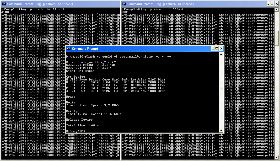

    If the system has 1 second lag at 9600 bps (that is very low / lite rate) in character echo, than I will call it not usable during debugging. This is related to FET's firmware CDC - UART bridge implementation.
    BTW, For 5xx devices there is SBW / JTAG Mailbox system (faster than 9600 bps for sure) that can be used for logging, but it is not supported by TI FET's.
