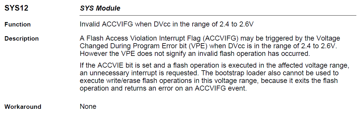

Hi
I have a question to SYS12 Errata.
What will be practical impact of this errata ? I understood BSL cannot be used for flashing.
JTAG(including SBW) can be used ?
Any other limitations come from this errata ?
Thanks and regards,
