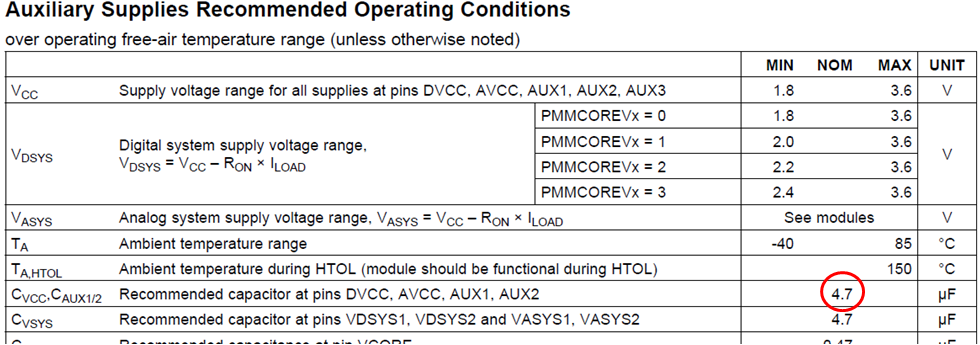

I have a quiestion about MSP430F6746 CVCORE(capacitor at VCORE) and  CVCC(capacitor at pins DVCC)
In this data sheet..
www.ti.com/.../msp430f6746.pdf
CVCORE should be 470 nF and CDVCC/CVCORE should be 10(MIN).
so, CDVCC should be greater than 4.7uF.
But in this table, CVCC should be 4.7 uF(NOM).
My understanding is that CVCORE should be 470 nF and CVCC should be greater than 4.7uF.
CVCC should not be less than 4.7uF.       I mean.. CVCC should be 4.7 uF(MIN) here.
am i miss understandig ?
