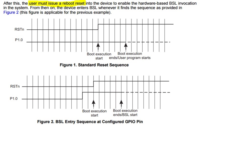

    Now customer wants to use MSP432, but way of FW update in his multi-processor environment has to be more or less compatible to existing MSP430 solution.
    He expects:
    - 2 pins connected to his host MCU (RST, + dedicated pin) to asynchronously start MSP432 boot strap loader (reset sequence may be ok and then start BSL ) druing running application + UART connection for data transfer
    - this Bootstrap behaviour (which pin, polarity, UART/IIC....) has to be pre-programmed in non volatile memory once (e.g. during production)
    - Initial programming of an empty device can be done via JTAG in production
    I went through actual documents you highlighted in post before, but I am not sure I understood it right.
    - Pls give a statement, if customer can perform a FW update in this manner ?
    - Do we have a running example ?
    - Anything else to mention ?
  • Yes. The Hardware invocation supports a GPIO signal on Ports 0 to 3 on bits 0 to 7( www.ti.com/.../msp432p401r.pdf ). I do not have a specific example but in the SLAU690 application you can see how to configure the BSL via the Flash Mailbox which can be programmed during production (www.ti.com/.../slau690d.pdf ).
    Please let me know if you have further questions.
    Chris
  • I am trying to do exactly the same thing. Using the MSP432, I want to have the firmware updated by the UART interface . What I am unclear about is the toggling of the RST signal. The document say the “user must issue a reboot reset”. Can the device jump through reset and invoke the same Bootstrap loader, or does the RST have to be physically toggled for it to enter the bootstrap loader? I am using P1.1 rather than P1.0 as shown below.
