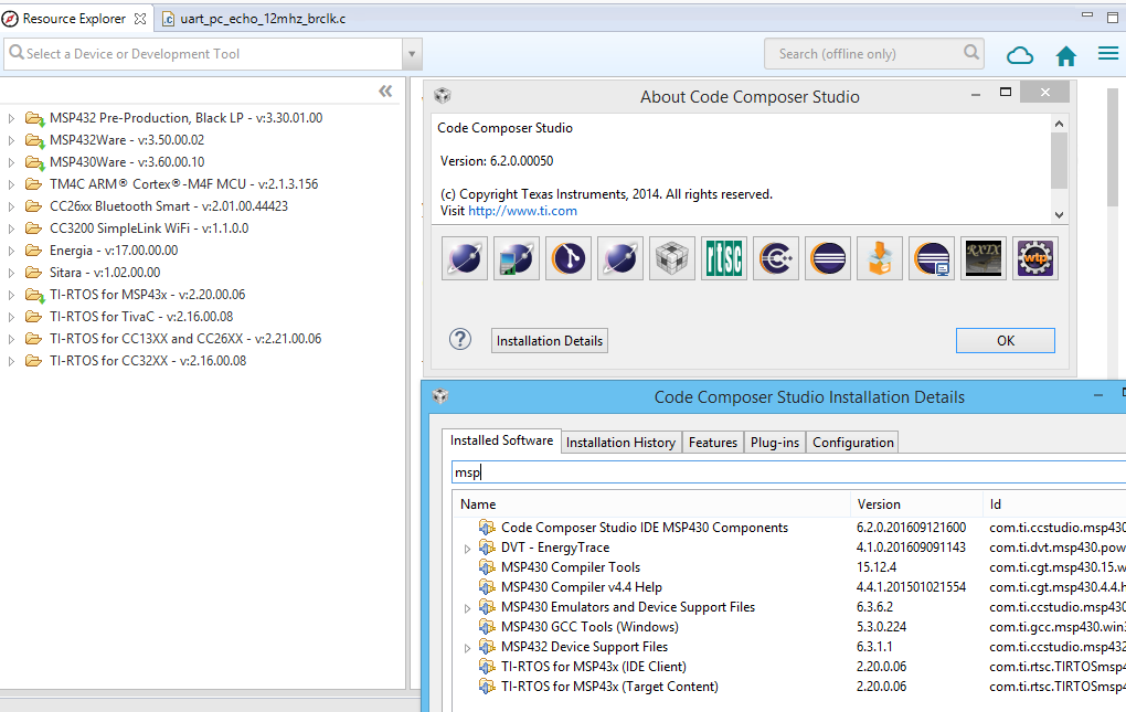

  • My board is MSP 432P401R Black, I have XDS110 install:
    I have CCS with version 6.2:
