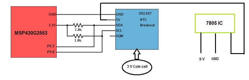

    When i measured voltage across SCLand SDA pin of DS1307 with respect to ground and found to be 4v in both pins.
    Please find below my circuit diagram.
    Please note that even if i remove DS1307 kit from circuit then also i am getting the value like,
    2000/0/0 0:0:0 , so as you said i am agree that DS1307 is not communicating, but how to make it working?
    Kindly support to fix this issue.
    HASEEL
  • MSP430 devices do not support pin voltages greater than 3.6 V, so your comment that the I2C lines are 4 V is a cause for concern. If the I2C lines of the DS1307 operate at 5 V (supply voltage of the device itself) then you will need to use an I2C isolator or voltage level translator to compensate.
    Ryan
  • Voltage level difference should not cause an issue. Since your pull-up is to 3.3V, there is no way SCL or SDA measuring 4V- suspecting some failure in RTC chip. The Vih min of DS1307 is 2.2V from datasheet. So with 3.3V pullup it should work. Btw what is the I2C frequency?
