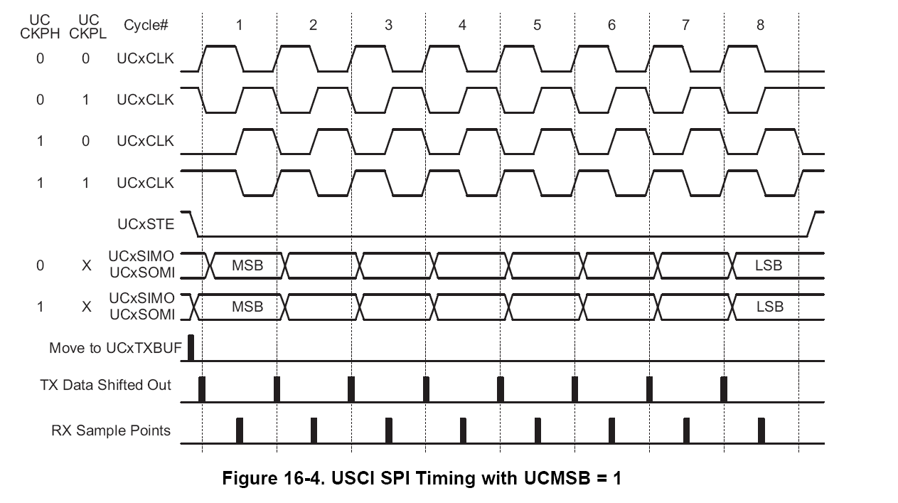

    i would like to ask a question  regarding clock phase and polarity during initialization of SPI.
    usually when i do initialization i keep both bit zero(UCCKPH and UCCKPL) and if slave doesn't respond i try different combination of both. but i never found any information in datasheet. for eg take the case of ADXL362 .
    msp430 user guide describe like this
    ADXL362  provide this info
    how to extract information of phase and polarity because what i see in above diagram is both bit 0.
    thanks
  • Hey sasuke uchida,
    Looking at the ADXL362 datasheet figure, SCLK is expected to be low when inactive and data is captured on a rising (first) edge/changed on a falling (second) edge. Therefore I would set the MSP430 UCCKPL to zero and UCCKPH to one.
