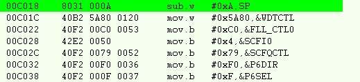

I have a C-code. I viewed its disassembly from IAR workbench. Refer figure. I understand that the first column is the address and 2nd/3rd are opcode/ data.
These are the first three lines of machine code (hex format) generated by IAR Workbench for the same C-code using this command line parameter (-Ointel-extended,(CODE)=.code.hex). I need to know which are the addresses and opcodes in this endless stream of characters. For example, to locate the field in the machine code which deals with the register WDTCTL (second instruction), I tried searching for C01C, 40B2, 5A80, 0120 etc but it didn't have any matches.
:020000020000FC
:10C00000314000033C4000023D404100B0129ACB59
:10C01000B01218C0B012BCCB31800A00B240805AB6
:10C020002001F240C0005300E2425000F24079008B
