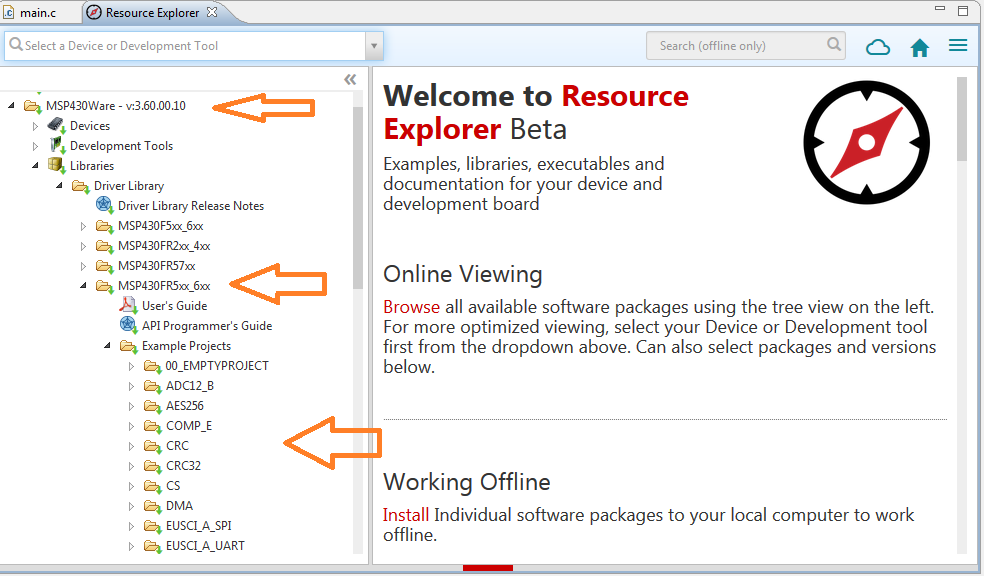

How to write a code for MSP430FR6989 with the help of driver libraries. Is there any driver library for this micro controller ?
Hi Subhash,
TI provides both a Driver Library and MSP430Ware for this device. Both are full of examples to get you started and can be accessed through the resource explorer in CCS once they have been downloaded and installed.
Caleb Overbay
Yes, you can use the Driver library inside the MSP430Ware.

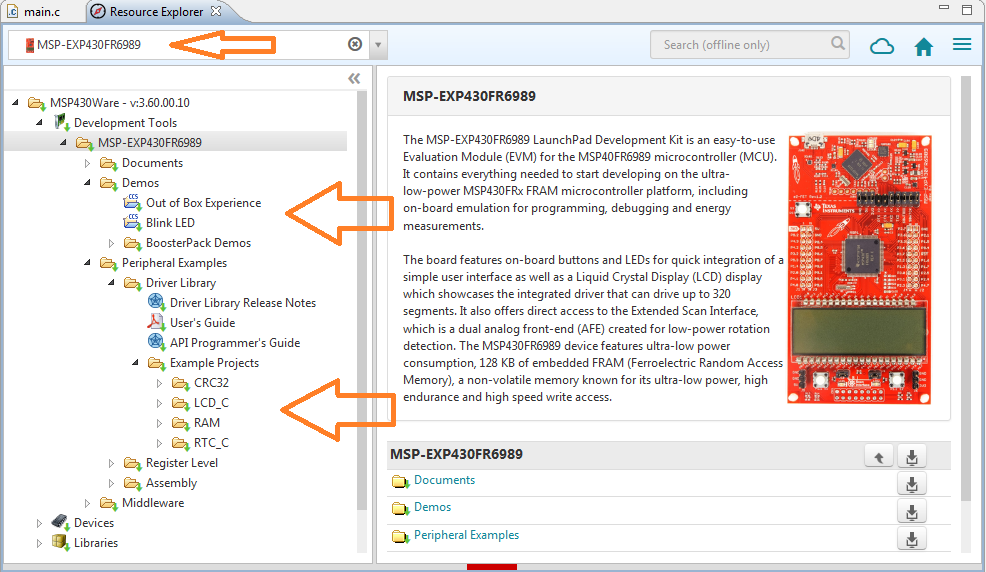

The simplest way to search the examples is to use the Resource Explorer inside the CCS, but the same examples are present in the MSP430WARE folder in your pc.
You can search based in the "msp-exp430fr6989" with specific examples or directly in the MSP430WARE folder. in this case can be necessary adapt some examples (made to different models).
