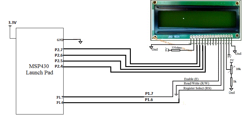

Hello sir/mam,
I am interfacing MSP430G2553 microcontroller with Silicon Technolabs LCD 16X2  Alphanumeric Display(JHD162A) .My code is  given below  and Hardware connections are also attached.After powering up the board,the LCD  glows but why the characters

are not showing?
