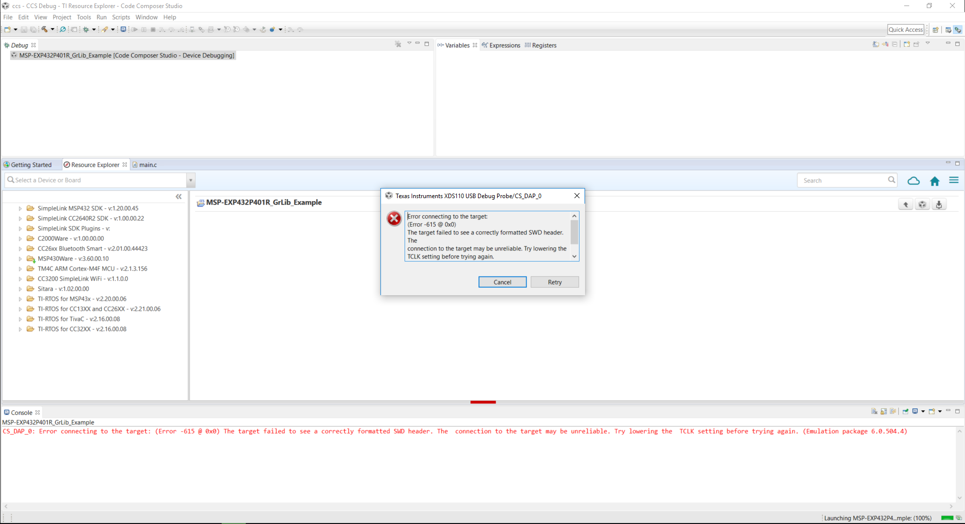

I am new working with MSP432 and I am using msp-exp432p401r rev1.0 (black). I am trying to debug the GrLib_example to use the LCD with CCS 7.0 but I receive the following error. Does anyone have similar experience with the Error -615?

I'd strongly recommend purchasing the red MSP-EXP432P401R with production silicon. The black LaunchPad has XMS432 Rev B pre-production silicon, so you'll have to use an older version of CCS (see IDE compatibility table in the XMS432 Support wiki for further details). However, support will eventually be removed for the pre-production silicon, so I don't recommend this option for long term development.
MSP432 revision C and red MSP432 Launchpad tools version requirements - MSP low-power microcontroller...
