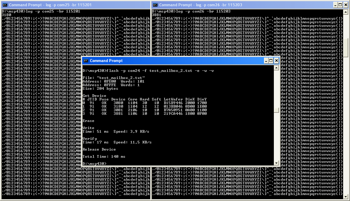

  • BTW, for log with 5xx devices can be used Mailbox system by existing SBW connection, without any extra wires, and setup problems. Unfortunately, it is not supported with TI tools. It is suported by my MSP-GANG like flasher that is working on OS X from Lion (10.7.5) till Yosemite (10.10.5).
