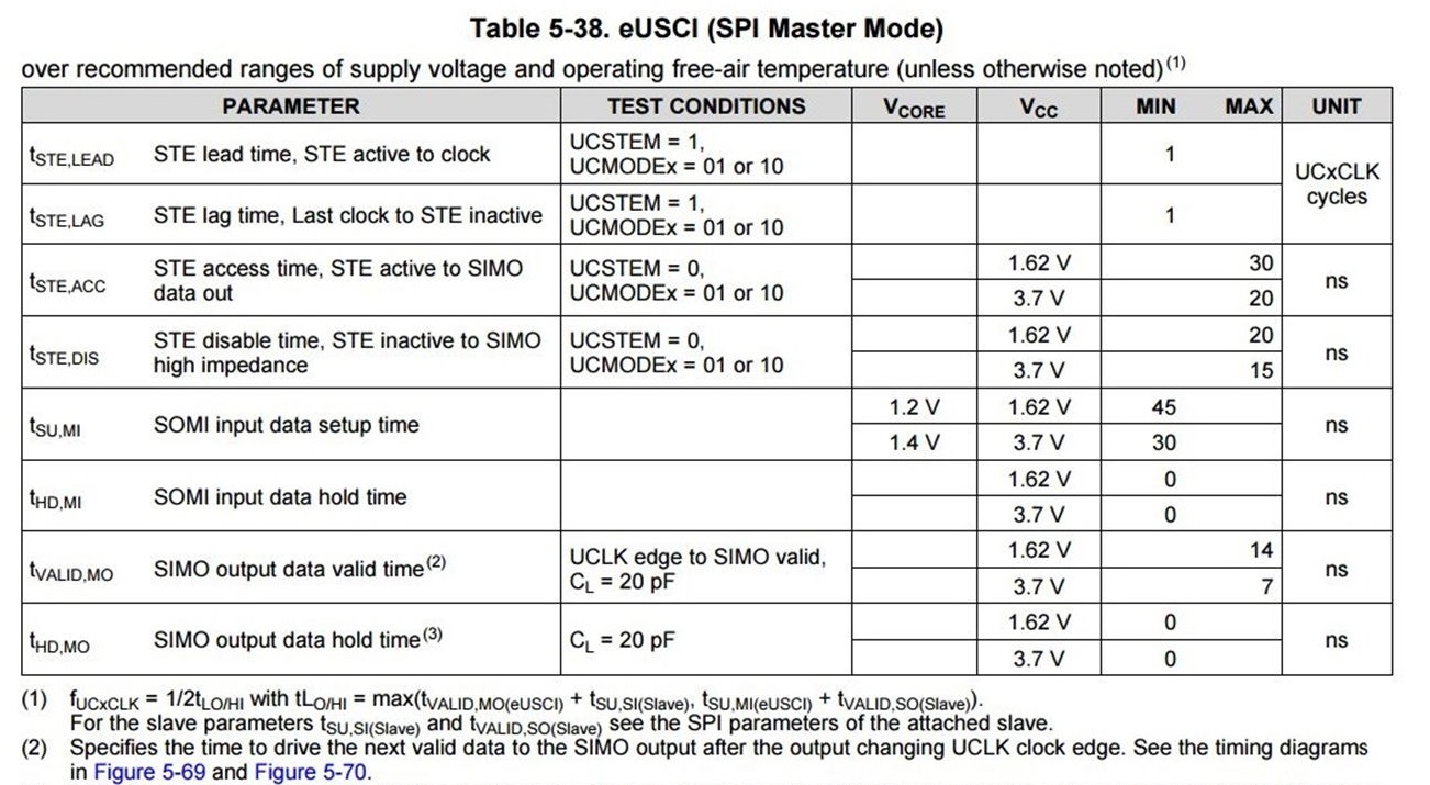

I have included an example to help provide some guidance. One of the concerns is that the maximum datarate of the SPI is specified as 16Mhz. In order to get 16Mhz out then the SMCLK must be 16Mhz (maximum specified clock input to eUSCI is 24Mhz, otherwise I would input 32Mhz).
Looking at the code that you have provided I could not see any issues. Hopefully you will be able to utilize or at least compare this code to what you have in it's entirety. I tested with another MSP432 to validate the data, so please let me know if you need that code as well.
Chris
Thank you very much for the example program.
As for the SPI clock frequency <= 16 MHz,
I found the lines you mentioned in the SLAS826B all right.
1 Device Overview 1.1 Features Serial Communication SPI (up to 16 Mbps)
I checked the "msp432p401r.pdf" and "MSP432P4xx Family Technical Reference Manual User Guide slau356e.pdf".
I found, SOMI : slave out master in = SPI read is slow, but SIMO : slave in master out = SPI write is very quick.
When I connect the MSP432 SPI Master and the MSP432 SPI Slave, SPI clock should be below 16 MHz.
But, when I connect the MSP432 SPI Master and the FRAM SPI Slave, maybe I can speed up the clock to 24 MHz, I think.
