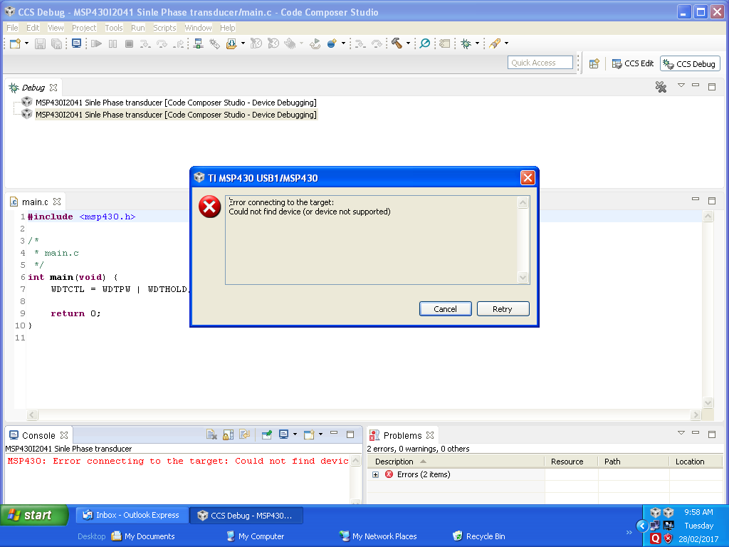

We are working on programming of MSP430I2041 by CCS V6.1.0 . We are using TEST,RESET,VCC,GND Pins for programming.
We select proper Target Configuration but "Device is not support" error occures.
So please provides me technical supports.

    The MSP430I2041 is compatible with CCS V6.1, what type of FET tool are you using? Can you confirm that the linker command file and project properties' device selection are correct as well? Are you using a TI EVM or custom board? Make sure that the RESET line has a 47 kOhm pullup resistor and 1/2.2 nF pulldown capacitor. Can you provide a screenshot of the error?

    We programmed successfully MSP430AFE252 MCU with above attached board image at time of programming we removed shorting links and we connected four pin connector wires between Emulation side section of above board and MSP430AFE252  to VCC,GND,RST,TEST .At this time we remove MSP430-EXPG2 MCU IC from board.
    But due to I/O pins issue we use MSP430I2041 MCU and we repeat all above process for programming and I was post to you the error screenshot.
    So please provides me your technical supports.

  • I will again repeat that the eZ430 FET on-board the MSP-EXP430G2 only supports F20xx, F21x2, F22xx, G2x01, G2x11, G2x21, G2x31, and G2x53 target devices. This does not include the MSP430I2041, please use a MSP-FET, MSP-FET430UIF, or any other MSP430 LaunchPad which has an on-board eZ-FET that supports all MSP430 devices.
