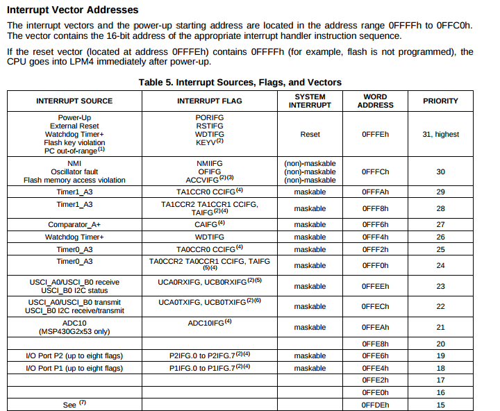

The intention of this question is to properly understand  #pragma vector=PORT1_VECTOR line
I now paste an excerpt from the datasheet below,
As per this, the place that must have the address of the ISR should be 0FFE4h. But I would not find the place within the CCS environment which does this operation.
However, I noticed if I write just 2 instead of PORT1_VECTOR, my code happens to work.  Below is an excerpt from the Msp430g2553 header where I view the content of PORT1_VECTOR. I find the way its defined a bit weird, in the sense that very difficult to understand. I would appreciate the uses of the following #defines could be more elaborately explained.
 My program worked when I simply had #define PORT1_VECTOR 2.
First,  I would like to know why #define PORT1_VECTOR 2 not written here. I can observe a ".int02". May be this is an integer 2? If so, why would the header file specifically mention the #define in this manner without simply stating #define PORT1_VECTOR 2 ? I would like to know that reason.  Would  truly appreciate your kind explanation there.
Secondly, where is the list of vector numbers relating to all interrupt sources? In this case, for PORT 1 interrupts it is 2, but surely in somewhere in this code, the actual memory address of the ISR must be written to the memory location 0FFE4h. Otherwise when an interrupt is triggered, the MCU would not know to direct to the ISR. I would like to see the code for this here. I could not find this implementation within the header file.
Thank you sincerely for all your answers and time.
  • When the compiler sees "#‍pragma vector = x", it creates a pointer to the following function, and puts that pointer into a section named ".intxx". (You can see these section names in the header file, where they are used when you include it from assembler files.)
    When the application is linked, the linker command file (named msp430‍g2553.cmd, which you should find somewhere on your computer) then specifies that the section ".int02" must be put at address 0xFFE4.
    The datasheet lists 32 possible interrupt vectors. But the first 16 are not used, so the header file just uses numbers 0 to 15 instead. (The actual number used does not really matter, as long as the header file and the linker command file agree on which number goes to which address.)
