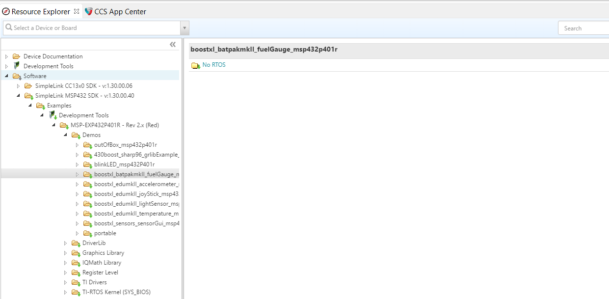

I am trying to locate the example "BOOSTXL-SENSORS_TI-RTOS_ SensorGUI_MSP432P401R" at SimpleLink MSP-EXP432P401R, however, it does not show up:
Do you know how to get this example to show up there?

    Thanks for pointing this out. I believe we are missing a link inside of the Resource Explorer.
    If you go to the software download page on the sensors boosterpack, you can find the RTOS varient under Download Folder>Firmware>Source
    software-dl.ti.com/.../index_FDS.html
    Please let me know if this resolves what you are looking for currently. Ill work on including this in the future update of the cloud.

    Actually I remember that the RTOS example was under cloud, however, after updating I noticed that it was not there anymore. That's unfortunate because importing the example from the zip file is not straightforward as doing it from the cloud since there are some compiler and linker path issues. Anyways, thanks for the help :).
