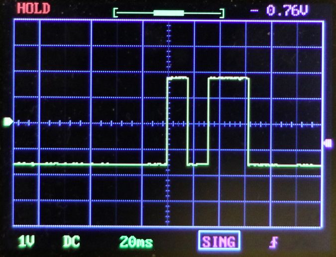

On my scope I see Test starts out low, then goes high for 10ms, back low for 10ms, high for 20ms, then back low.
/RST starts low, then goes high for 50ms, then back low.
I believe these are the patterns described in slau319 if I assume /RST goes back low because it doesn't receive an ack.

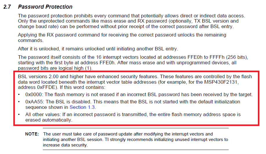

  • Hi George,
    did you check if the code you initially programmed does not disable the BSL as described in slau319
    Dietmar
  • Yes, I have 0000 at that location. But FFFF doesn't work either, so that's not the problem.
  • Ok I've figured out the problem with the /Reset Test BSL initiation sequence.  Both DTR and RTS do exactly what they are supposed to do (per slau319), except that DTR is inverted.  So as it is, it does the opposite of the required pattern, and goes back into reset at the end.  So it's no wonder it doesn't work.  RTS is fine though.  I'm not sure why only one would be backwards, but I guess all of this originates back when computers had real serial ports, so who knows what was assumed about polarity.  But you know, we've had these USB-to-serial adapters for a while now, and I would have hoped TI would have made a version of BSLDEMO that worked with them straight through, without the need for an inverter.  If there is such a version, someone please give me a link.

  • The first picture shows the RTS-Test line during the initial sequence.  As you can see, it's the same as the drawing in slau319 for parts like the G2553 with shared JTAG pins.  The second picture is the DTR-Reset line, and as you can see, it is inverted from the desired pattern.  It should be normally high, then go low to begin the pattern, then go back high at the right time, and stay there.  I apologize for not having a working 2-channel scope, but I believe these pictures show what's happening on each line, although not the relative timing between the two.  But it's obvious that DTR-Reset is inverted because it stays low after the sequence, which would keep the chip in permanent reset.  Of course it should stay high.
    Instead of using an external device like the Rocket, I want to embed a USB-to-serial chip in the project design so that flashing can be done with only a USB cable.  For that purpose I would use a CP2102.  For breadboarding purposes, I'm using a module containing a CP2102, its capacitors, a USB connector, and some indicator LEDs, but functionally it's just a CP2102.  This part is similar to other such USB bridge chips like the FT232 and CH340, and I believe TI also has one that's used in the Launchpad-G2.  These chips operate in a different environment than the one in which BSLDEMO was written, where computers actually had serial ports.  There are no inversions, or double-inversions, as described in the hardware section of slau319, and no need for DTR and RTS to provide power.  It would be nice if BSLDEMO worked directly with the USB bridge chips without the need to use additional parts to invert DTR back to the correct polarity.
    I know this is all deprecated stuff, but BSLDEMO2 remains the only software which allows for BSL flashing of 1xx, 2xx, and 4xx parts, and there ought to be a version of it that works with these USB adapters.  I believe the only modification needed to the source code of version 2.01 is to change line 72 of bslcomm.c:
