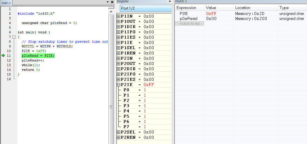

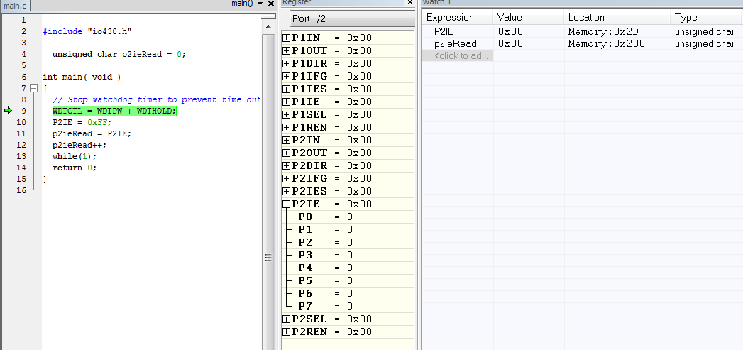

    The debugger window looks like this before read/write,
    After the write to P2IE,
    and finally after reading it back,
    please let me know what you would like for me to investigate.
