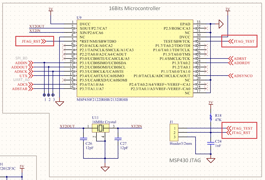

I connect SBW signals of eZ-FET Lite (MSP-EXP430F5529LP) to MSP430F2122 which install to my board. The ccs flash failed to F2122, it will show "Error connecting to the target:Unknown device". I have another different board which install F5325, use same method (SBW) can programming success without error.
My question is "Can eZ-FET Lite (MSP-EXP430F5529LP) support MSP430F2122" ? I don't have MSP-FET to verify this question. So, hope can get answer from here. Thanks in advance.
