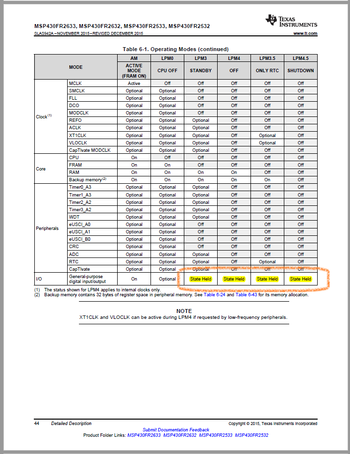

Could you please tell me the meaning of the words "State held" in the LPM modes ?
What is the difference against the "On" in the AM mode ?
Section 7.3.3 of the User's Guide says:
During LPMx.5 the I/O pin states are held and locked based on the settings before LPMx.5 entry. Note that only the pin conditions are retained. All other port configuration register settings such as PxDIR, PxREN, PxOUT, PxIES, and PxIE contents are lost.
