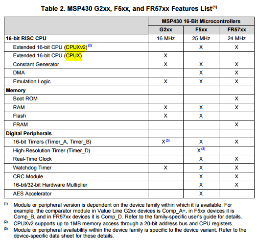

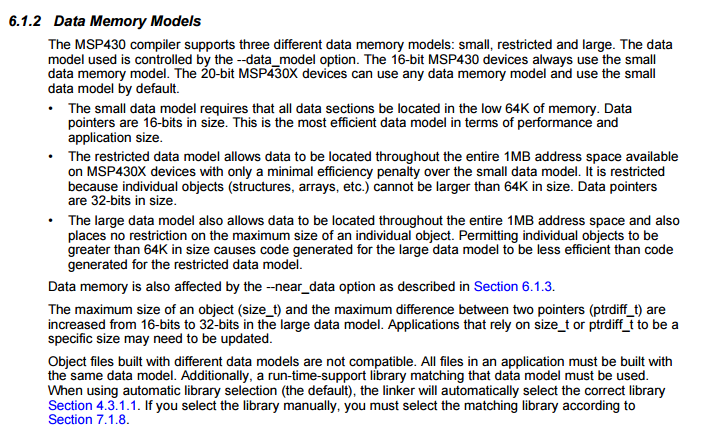

    The 16-bit MSP430 devices like the MSP430i20xx always use the small data memory model whereas the 20-bit MSP430X devices can use any data memory model and use the small data model by default. For the MSP430i20xx devices, the largest Flash size offered is 32KB, which is not even close to the 64KB limit for the small data and memory models. More information about the Code and Data Memory Models can be found in Section 6.1 in the MSP430 Optimizing C/C++ Compiler User's Guide.
    This warning in CCS is just alerting you that the small data model is being used. For the MSP430 IEC60730 software library, the families of the tested devices all have the CPUX architecture (instead of the CPU architecture of the MSP430i20xx), which allows them to use the large code or data models. The table below is from the Safety Manual for MSP430G2xx, MSP430F5xx, and MSP430FR57xx Devices in IEC 60730 Safety Applications User's Guide.

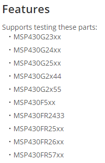

    Finally, the MSP430i20xx devices aren't listed as a device that was tested with the MSP430 IEC60730 software library. I'll check with our IEC experts to see if the MSP430i20xx can be used with this library or not.

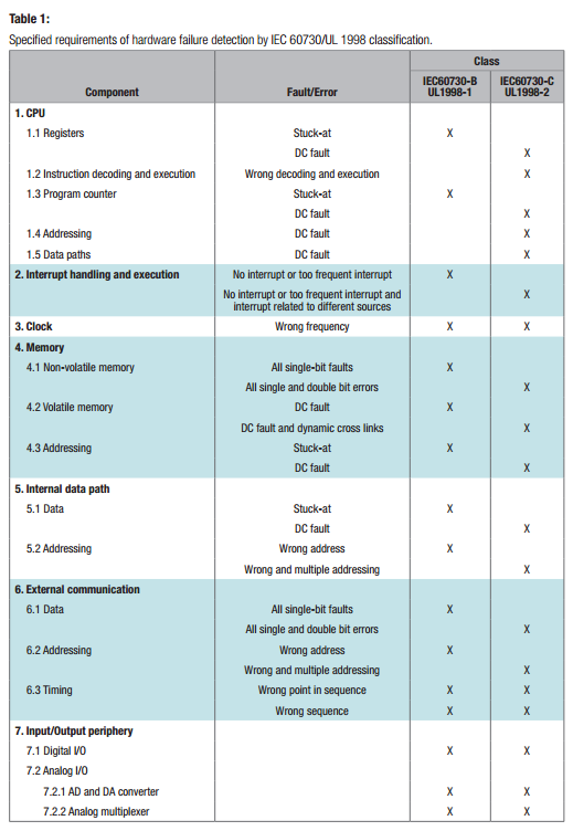

  • Looking at Table 1 in the IEC 60730 and UL 1998 Safety Standard Compliance Made Easier with TI HerculesTM MCUs white paper, it appears that IEC60730 Class B and Class C certifications require tests for the wrong clock frequency, so if this can't be done on the i20xx devices, it may not be able to pass this certification completely. Perhaps this is the reason why it's not listed as a tested device on the MSP430 IEC60730 software library product page.
