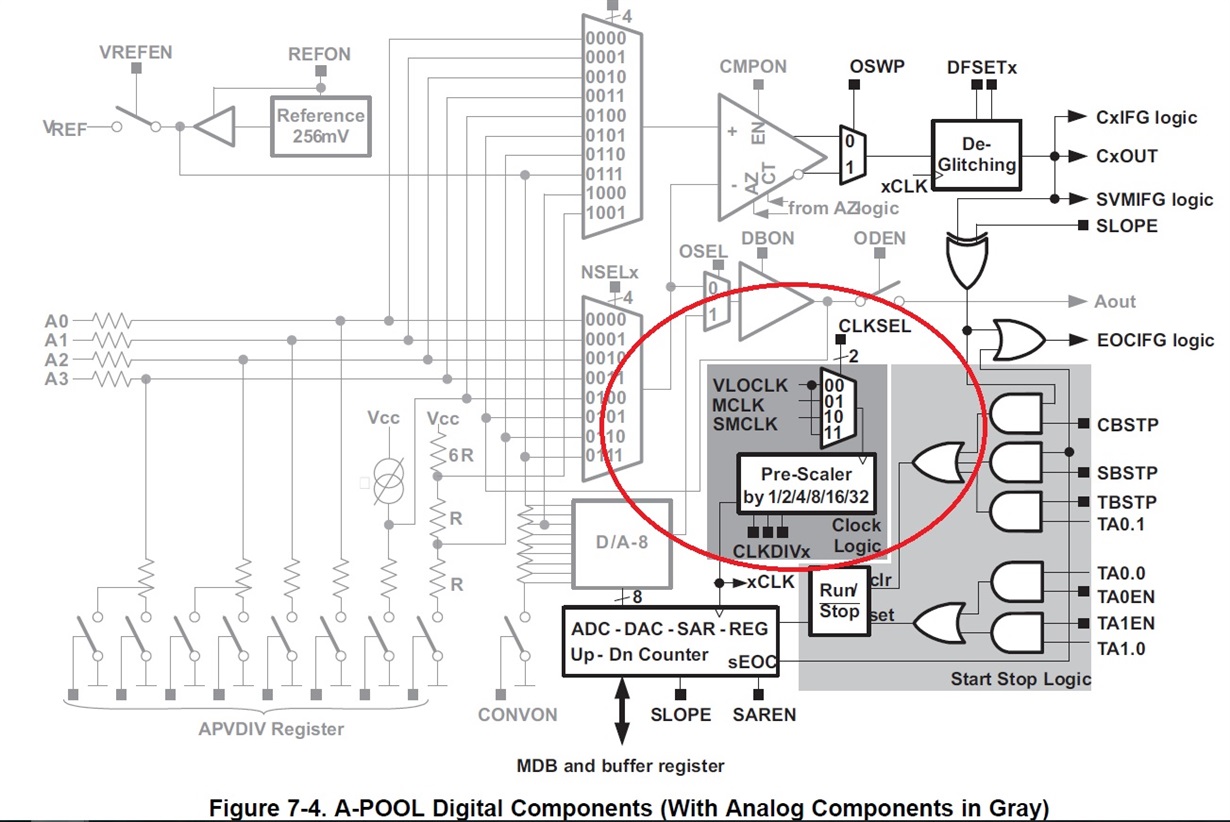

    It seems you are not setting up your clock from default values. By default, the DCO will go to 1MHz and MCLK has a divide by 8. This would mean you are running at 125kHz and sampling at the same speed (since you choose MCLK to be ADC Clock). This is the reason why you see such a delay.

    Timing wise, you are not changing MCLK so this application will run slow, thus your delay. In the above code, you will go into LPM0 until your Timer interrupt is raised. Then within your Timer ISR, you need to exit LPM0 in order to continue your code.
  • Thanks for quick reply. Your solution is changing clock division, isn't it? I tried "CLKDIV0" (A-POOL Prescaler Control Bit: 0*/). It doesn't work.
    In my code, If I set up if(DegC>40), P1.4 pin is going to be high later 50 seconds. I think that this example code is not working correctly. My sensor value is increasing second by second. I observed that When time is up I mean that after 50 seconds, my led is blinking 2 times and then it turns on constantly.
    Is there another example code to measure built-in temperature sensor value for msp430l092?
    I couldn't measure it exactly.
    The clock division I spoke of is not within the APOOL nodule, but the clock system. The clock system in its default state, configure the DCO to 1MHz, the divides that down to 125kHz for MCLK and SMCLK. If you want your application to run faster, please see the examples located within MSP430 for changing your clock system to 1MHz or higher.
    As far as temp sensor examples, we only have one example of this and it is msp430x09x_apool_adc_06.c located within MSP430Ware
  • In clock system, I tried to add up below code from example msp430x09x_ta_07 for setting up clock but there is no change. I still suffer from this delay problem. I consider that DegC is increasing second by second so it always increases .

  • I added up the code ( APOMR=CLKDIV_0; ) for clock division APOMR is A-POOL Operation Mode Register but I couldn't solve this problem. Please, can you correct my mistakes?
    As stated before, the issue is not the clocking of the ADC, but of the clock of your whole system. You need to increase the clock speed of Mclk in order to run through your application at a faster rate. You can then run the ADC of off the SMCLK at a lower rate that matches your needed ADC sampling specifications.
