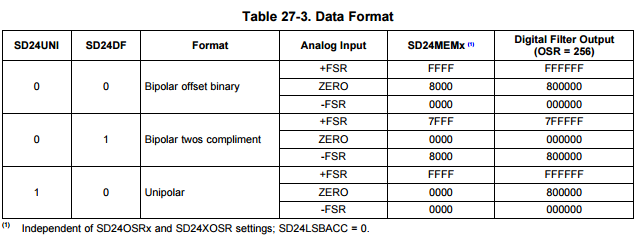

    I'm not sure I completely understand this. Are you saying that your timer is configured properly but that you're getting samples from the SD24 that are different than you expected? I see that you're setting the "SD24DF" bit in the SD24CCTL0 register. Looking at Table 27-3 in the User's Guide, this makes the data format "bipolar twos compliment". Perhaps the results are correct but in a different format than expected.

  • I set the bipolar complement output, but all I read was negative, and the signals I gave were AC.

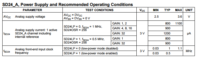

    According to page 28 in the datasheet, the maximum input (modulator) frequency to the SD24_A module is 1.1MHz, whereas 1MHz is typical. Let's call this input frequency F(m).

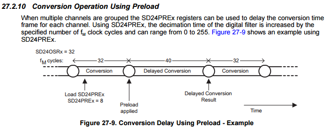

    t(conversion) + t(delay) = ( OSR / F(m) ) + ( SD24PREx / F(m) ) = ( OSR + SD24PREx ) / F(m)
    You can learn more about this in Section 27.2.10 in the User's Guide. Also, the SD24INTDLY bits don't delay the conversion itself. These bits determine how many initial conversions (samples) are thrown away during the settling time to prevent wrong conversions. These bits are very different than the SD24PREx bits.

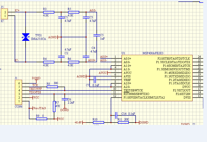

  •  please help me  check my Schematic.
  • Hello Alvin,

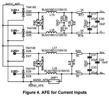

    Based on the configuration of the AFE for A0.0 in your schematic, it looks like you're measuring current with a single SD channel. If this is true, I'd strongly recommend referring to the schematic portion shown in Figure 4 (and Section 2.1.2.2) in the Single-Phase Electric Meter With Isolated Energy Measurement (Rev. A) User's Guide. In your schematic, you may want to replace R3 and R4 with inductors. Also, C1 and C2 may just need to be do-not-populate (DNP). More importantly, if you are using a current transformer (CT), then you'll want to add a burden resistor as shown in Figure 4. Also, I would recommend changing the values of C3, C4, and C5 to match those shown in Figure 4.

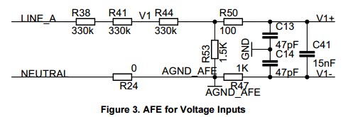

    If you want to use this channel to measure voltage, I'd recommend that you refer to Figure 3 (and Section 2.1.2.1) in the Single-Phase Electric Meter With Isolated Energy Measurement (Rev. A) User's Guide.
    Here's some additional feedback (based on the schematic for the TIDM-MSP430AFE253SUBMETEREVM board found here):
    1. Add at a 10uF capacitor and 0.1uF capacitor to AVCC.
    2. At 2.2nF, C6 is at the upper limit of recommended capacitance. Depending on your board's parasitic capacitance, you may need to reduce this value to 1nF or slow down the SBWTCK speed.
    3. I'm assuming that you're connecting DGND to AGND with a net-tie somewhere else in the schematic.
    James
