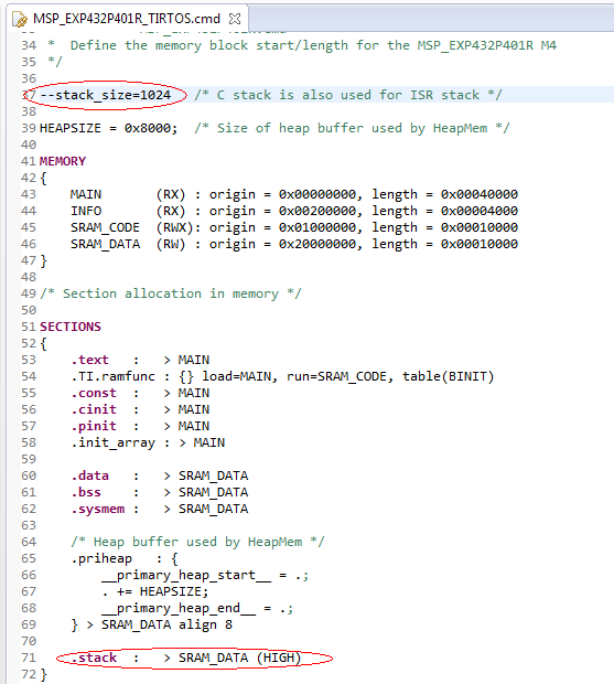

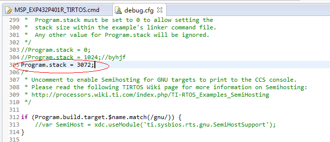

Hi
      I am using msp432 with tirtos. When debugging,  I find stack overflow error
     I want to increase my stack size. I find there are three positions that can change stack size, such as
1、in ccs properties
2、in cmd file
3、in tirtos cfg file
What are the differences between the 3 method?
How can I know which stack is overflow and which param mentioned above should I modify?
Thank you.
  • Hi Jufeng,
    First of all the comment in the .cfg is not correct for all devices (namely the MSP432 devices). I've opened a bug report in it.
    Here is the order that is used to determine the stack size.
    1. Use Program.stack value in the .cfg file unless it is zero
    2. Use --stack_size in the linker command file if it is present
    3. Use CCS project setting
    4. If none are available you get the codegen default. For example: “#10210-D creating ".stack" section with default size of 0x800; use the -stack option to change the default size”
