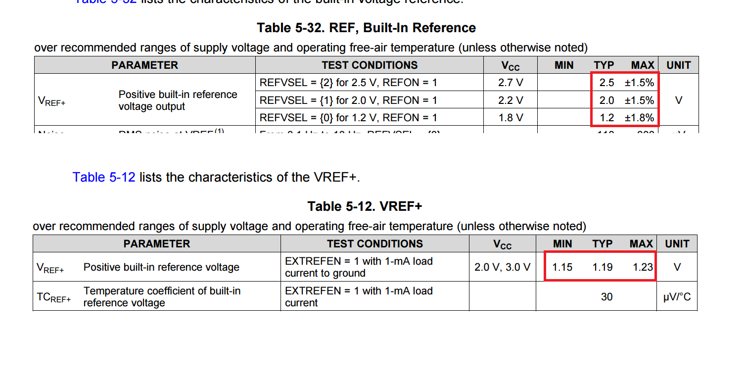

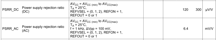

How VCC variation influence the Internal REF module
Hi Champs,
Would you kindly suggest how VCC variation influence the Internal REF module? For example, if Vcc changed from 3.3V to 3.6V, what's the variation of REF?
Thanks.
