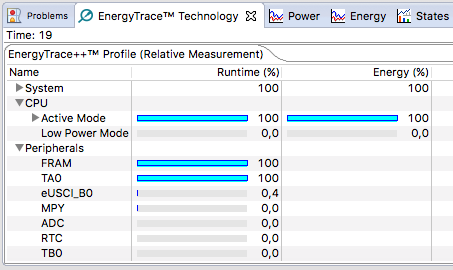

    I have measured the energy following several ways: with Energy Trace in both debug and no debug mode and with a external multimeter.
    Moreover, Energy Trace++ was not set by default and after activating this tool I have tested several things.
    I have observed that adding the fatfs module to the .cfg file the micro controller is working about 5-6 % in active mode and the rest in LPM3. However, removing the fatfs module the active mode percentage is reduced below 1 %.
    I need to use the uSD card in my project. Is it possible to use the fatfs module dynamically and avoiding this extra power consumption?
    Thanks and regards,
    Juan Antonio

    1.- Testing the original fatsdraw project for MSP430FR5994 the device is only working in active mode.
    2.- I copy and paste the previous project and configuring low power mode and removing "idle" component in the .cfg file, these are the results:
    The active mode is about 6% (bad number for power consumption). The device is switching many times between LPM3 and AM.
    I tried to remove the fatfs component, but some error appear when building the project.
    3.- The original fated project provides similar results as fatsdraw project. Later, I copy and paste this project with another name, I removed the idle and the fatfs componentes and I configured the low power mode as above. These are the results for these conditions:
    I like too much these results: the active mode is below 1%, there are little changes between AM and LPM3 and the project is working.
