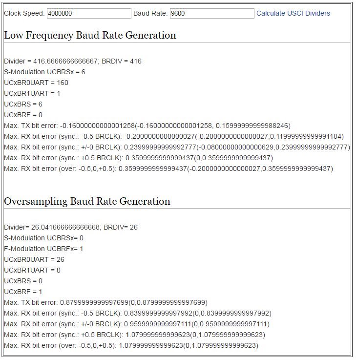

  • Hi Harish,
    If you're going to be using the SMCLK at 4MHz, your prescalar settings are still incorrect. When plugging the numbers into the baud rate calculator I get the following:
    You can see the max bit error is lower for the non-oversampling method so I recommend using those numbers for your registers.
    Also, how are you interfacing the MSP430F5659 to your PC? Are you using the device on a custom board as well? Can you connect a logic analyzer to the TX/RX lines and monitor the baud rate?
