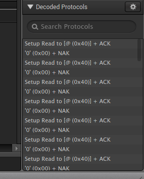

  • Thanks Bruce for the quick reply. I couldn't see the forest for the trees.
  • Corrected that problem and made a few modifications to code. Program appears to be skipping my transmit start/writing TxData to the slave device. Only getting read onto bus.

  • > while (TxByteCtr)
    >while (RxByteCtr)
    These two make me suspicious, though I can't immediately tie them to your symptom. In general, you can only receive/send one byte per interrupt. (This isn't so bad since I2C is pretty slow.) The first probably isn't affecting you now, since TxByteCtr is always either 0 or 1, but the second probably is (or will be).
    Whenever I have to take on an I2C device, I go back to the state diagrams in SLAU356A (or equivalent) Figures 24-9 (ff) and do as they say.
