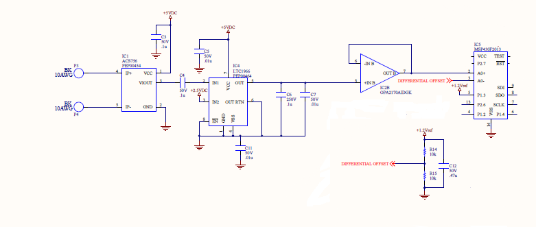

  • This application to measure AC current. A0- = 0.6V(ref) and A0+ get voltage 0 to 1.2V. This system run 24/7 and A0+ ~ 0.8V in almost time.
    I measure all pin but no pin over Vcc+0.3 and It cannot be exposed to ESD because circuit board is always inside plastic box which protected by chamber panel.

    Katie's currently out of the office, so I'll do my best to support you. Thanks for providing a portion of your schematic. Initially, I was surprised that the differential voltage inputs weren't connected directly to the +/- pins of the SD16 module of the MSP430F2013, but it looks like you've added some external devices to perform isolation (ACS) and other functions. I'll assume these are working properly.
    I agree with Katie that it's very important that the MSP430F2013 is powered-up before all these other devices are applying input voltages. Assuming you're powering the MSP430F2013 with 3.3VDC (unfortunately, this wasn't shown in your schematic), this would most likely be sourced from the 5VDC rail. Thus, all of these devices (and perhaps others not shown) would power-up first and could be applying voltages above our maximum values to the pins of the MSP430 before VCC equals 3.3VDC. Can you please check this with a scope during start-up? This would explain why the MSP430 would work for a while and then stop working and also why replacing the device is the only way to fix the issue (at least temporarily).
    Also, I noticed that you're configuring the SD16 module to use the internal 1.2V reference, but you also seem to be using an external 1.2V voltage reference as well. I'd strongly recommend that you use one or the other. If you want to output the internal 1.2V reference voltage, you'll need to enable the output buffer and ensure there's a 470nF capacitor is connected between Vref and AVss . If you want to use an external reference input, you'll need to disable the internal 1.2V reference voltage and configure P1.3/VREF correctly.
    Please carefully perform these measurements and resolve the reference voltage source discrepancy before we continue.

  • Hi James,
    I think that I use internal 1.2V reference. It was generated from pin P1.3 and Pin A0- get 0.6V which sourced from 1.2V and 2 resistors. And I connect 470nF between P1.3 and Vss also (lower part in schematic).
    I set up enable output buffer too (SD16VMIDON=1) and MSP430F2013 is on all the time so I'm really sure that the MSP430F2013 is powered-up before all these other devices are applying input voltages.

    Thank you for confirming that you're using the internal reference and that the MSP430 is powered-up before the other devices. Also, I missed the 0.47uF capacitor across the resistor ladder in your schematic, so thanks for pointing that out. It seems like your code is working, so I'm concerned there's a hardware issue damaging the device.
    Do you know if this issue occurs at a high temperature?
    Can you confirm that voltage spikes are not damaging the MSP430? I don't see any TVS diodes or varistors on the front-end, although it appears that you're using an isolator. However, what would happen if a spike occurs on the input of the isolator? Does its output respond accordingly?
    After the issue happens, can you share the state of the SD registers? It'd be helpful to see if any interrupt flags are set that could indicate the reason of the issue.
    How repeatable is the issue? Are there specific steps and conditions to make the device fail? If so, please document them and share them.

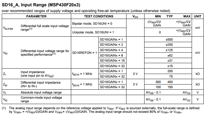

    Since you mentioned earlier that your differential voltage input range is from -0.6V and 0.6V, I took a look at Section 26.2.2 in the MSP430x2xx User's Guide where it mentions that for a gain of 1 and a 1.2V voltage reference, the maximum full-scale input range is +/-0.6V. Looking at page 43 in the MSP430F2013's datasheet for the specific full-scale input specifications, you can see that for a gain of 1, the recommended full-scale range (FSR) is +/-0.5V (500mV), not +/-0.6V. Also, you can see that Footnote 1 specifies that the "analog input range should not exceed 80% of VFSR+ or VFSR-".
    Also, since you're using Bipolar Offset Binary format, this means that an Analog Input equal to -FSR would cause SD16MEM0 to equal all zeros. This would mean that the input voltage would be equal to zero, since 0V (A0+) - 0.6V (A0-) = -0.6V. You mentioned that "you have voltage input". Did you measure the voltage at the pins of the MSP430 to confirm that the other external devices are actually applying a voltage when the high voltage was applied to the front-end inputs?
