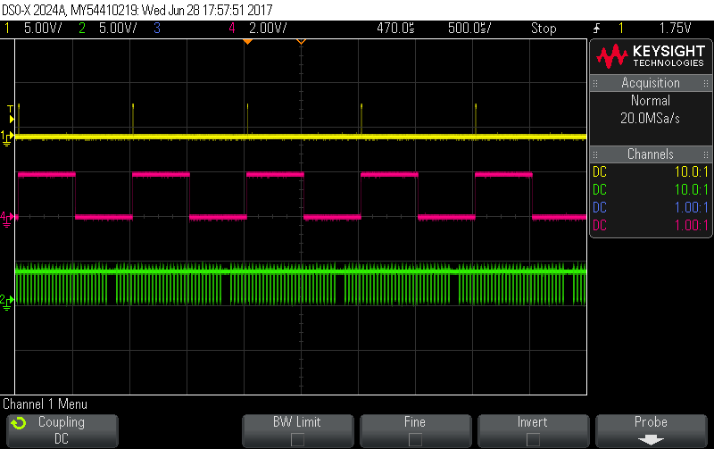

  • Trigger Input Signal: 1 kHz
    This is the case, when no USB transmissions are ongoing (ch1: Output pin, ch4: Trigger Input Signal ch2: USB signals)

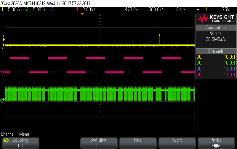

    This is the case, when USB transmissions are ongoing (ch1: Output pin, ch4: Trigger Input Signal ch2: USB signals)
  • This looks as if you want to detect the rising edge of the trigger signal. And as if the GPIO interrupt happens only when there is a pause in the USB traffic.
    Please show the main loop of your application.
  • The main Loop is posted 3 Messages above. There is quite an irregular latency between the rising edge and the Interrupt service.
  • The code continuously polls the status of the CDC interface, but that should not prevent the interrupt.
    This looks as if one of those functions disables but then not correctly re-enables interrupts. Try adding checks to the main loop (and to the waiting loop in SendInBackground) to see if the GIE flag got cleared somewhere.
