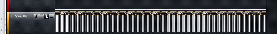

    I followed your suggestions. I first tried the code change you provide and that significantly reduced the recurrence of the issue. I have been able to run the update software over 500 times without seeing the issue. However, I can still get the issue show up randomly. I also checked the signal integrity for the TX and RX signals, and they seem to be clean (I haven't been able to catch a waveform of the fault since it is so random). I am right now looking at the TX and RX data coming between the radio and the MSP432 to see if I can catch anything.
    For the moment, I have also added a Watch Dog Timer when entering the sendByte function. if the WDT is triggered, an ISR function calls a mass erase so I don't lose communication with box.
    Do you have any other suggestions?
