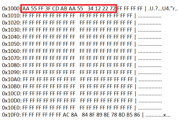

hi,
When I read out the Information Memory of MSP430F22X4, I awlays found some data in segment D,
do you know what's that? if i erase it, what's the side effect will it happen? Thanks for you care about my question.

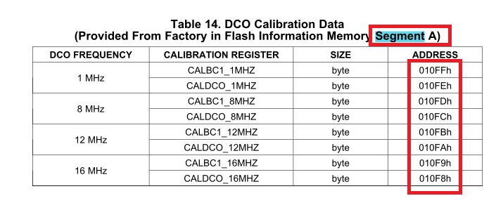

The data you marked is in Segment A.
Segment A contains calibration data. After reset, segment A is protected against programming and erasing. It
can be unlocked, but care should be taken not to erase this segment if the device-specific calibration data is
required.
