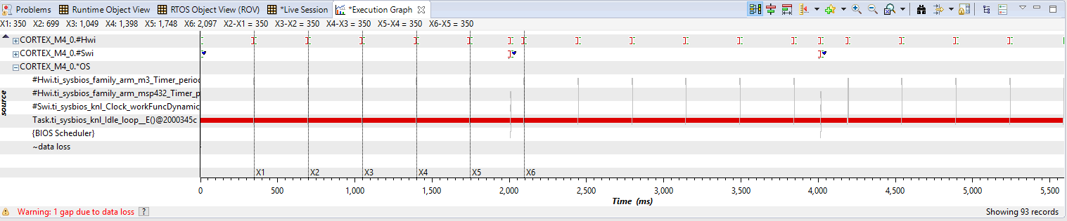

I'm currently playing around with the MSP432 using simplelink_msp432_sdk_1_40_01_00 and want to get power usage a bit lower, so was hoping you could clarify a few things. I'm using the PowerMSP432_sleepPolicy but plan to switch to deepSleep later on, but I get the same behaviour with both policies. So, I register notifications fort PowerMSP432_AWAKE_SLEEP and PowerMSP432_ENTERING_SLEEP (and deepsleep variants when using deepsleep), then set a pin high when awake, and low when asleep. I then have a single task which is below:
void main_task(UArg arg0, UArg arg1) {
    while (1) {
        Task_sleep(Clock_tickPeriod * 10);
I see my pin go high/low every ten seconds, as expected. However, if I monitor when the system clock ticks, I notice that I get a HWI every 1000 microseconds (as configured), or if I enable tick suppression I get a HWI about every 350ms.
I'm using the timer that is automatically configured by the Clock module, which is presumably a 16-bit timer (TimerA?) with a period of 1000us.
So I have a few questions:
  1. Can I increase the time between ticks (with tick suppression enabled) while also keeping a 1000 us period? i.e. I don't want to wakeup every 350ms. If so, how? If not could you explain the constraints?
  2. If I have to change clock source to (e.g. RTC), would I have to implement tickless stuff myself? For example, would I need to determine when the next wakeup is due and schedule a wakeup accordingly? I would assume I could hook into the current tick suppression stuff, but advice would be much appreciated :)
  3. It's my understanding that LPM3 and LPM4 (DEEPSLEEP0 and DEEPSLEEP1) both disable internal timers, which according to the link below should prevent both periodic ticks and my 10 second wakeup. However, even when in LPM3 (using deepSleepPolicy), I still get my regular wakeups. Why is this? My tickSource is ti.sysbios.knl.Clock.TickSource_TIMER.
  • Hi Campbell,
    The kernel's tickless mode does not work with the RTC or WDT. You would have to do it yourself.
    The confused where the 350ms interrupt rate is coming from. Do you have something scheduled to go off then?
    Todd

    Thanks for the reply. Yeah, I'm not sure what the 350ms is either, but I don't have any scheduled wakeups, and I don't have any interrupts enabled. If I enable execution analysis, I see that it's all related to the system timer / clock. I've included a screen shot below:
    Ignore the data loss, that was just due to me pausing in debugger at the start of main. But as you can see, every 350 ms I get a HWI for ti_sysbios_family_arm_m3_Timer_periodicStub__I, and every 2 seconds I get one for ti_sysbios_family_arm_msp432_Timer_periodicStub__E, which then runs its SWI (ti_sysbios_knl_Clock_workFuncDynamic__E). My sleep policy is PowerMSP432_sleepPolicy. I have disabled all of my tasks and my main function is below:

    I have also included my .cfg at the end of this post. Am I doing something silly here? Happy to get more data if needed.
    edit: I just tried a 100,000 us tick period and still notice the 350ms wakeups, I'm not familiar enough with TI-RTOS to say why...

  • Hi Campbell,
    First of all...your reply was awesome! Perfect usage of the execution graph!
    We'll try to reproduce the issue and figure out what is going on.
    Todd
  • Hi Campbell,
    The M3 Timer (SysTick) is firing every 350ms because it has 24 bits before a roll-over occurs. We have the ISR run every 350ms (actually a little less than 350ms) to handle that roll-over (2^24 / 48MHz = 350ms). This timer is coming in to provide timestamps that we needed for the logging.
    You have a couple options to get rid of this
    1. Stop logging
    2. Configure the timestamp module to use a different timer.
    Unfortunately disabling timestamps in LoggingSetup (LoggingSetup.timestampSize = LoggingSetup.TimestampSize_NONE;) and not doing a useModule of the Timestamp in the .cfg file does not work. The timestamp module is still pulled in. I'm not sure if this is a viable solution anyway if the execution graph is needed.
    Please note on the MSP432, the MSP432 timer will still fire every 2 seconds even with tickless mode. (2^16 / 32768 = 2 seconds.
    Todd
  • Thanks Todd, that makes sense. I want to do stuff about every 5 minutes, so it's probably easiest to schedule a wakeup with the RTC and then shutdown and not worry about the 2 second tick :)
