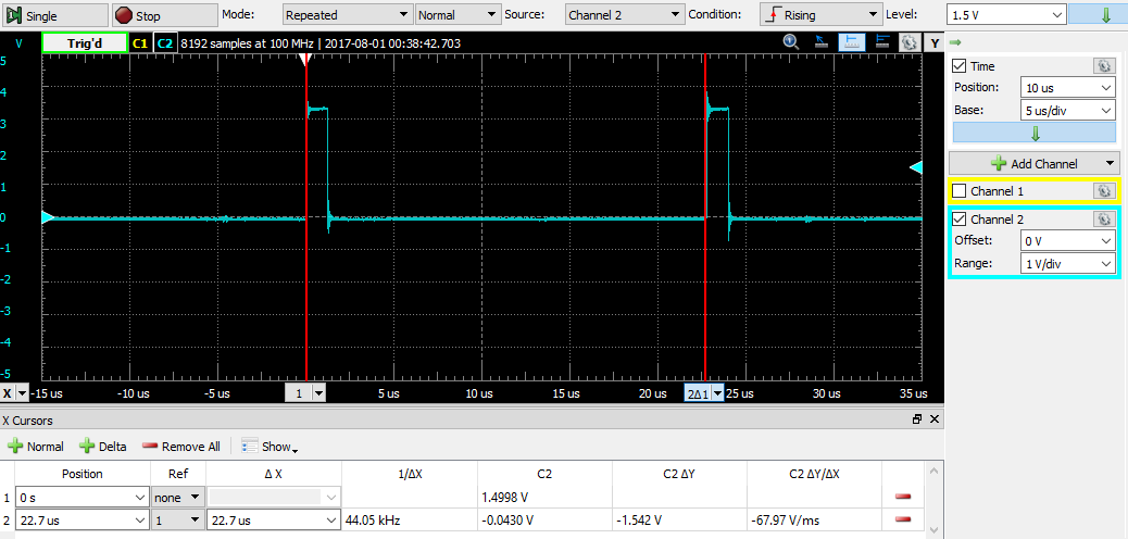

My end goal for this project is to sample audio from an amplified electret microphone, and store it in SRAM (short sample, I know) using DMA.
Currently, the output of my microphone circuit looks perfect through an oscilloscope. I'm running my MSP432 at 48 MHz; so I should be able to sample at 44.1 kHz without a problem, though I will probably sample slower just to save RAM.
My ideal scenario is as follows:
  1. Automatically trigger ADC conversions at a rate of 44.1 kHz using Timer_A0.
  2. When each conversion is completed, automatically transfer sample to memory.
The problem I am running into is that I can't get the ADC to trigger automatically using a timer. I can't find any example code that doesn't use the DriverLib API.
So FOR NOW, I am trying to manually trigger a conversion at 44.1 kHz using a timer interrupt. I configured Timer_A0 in UP mode, with a CCR0 value that triggers a timer overflow interrupt at a rate of 44.1 kHz. So my timer is working perfectly, but when I start a conversion inside my timer interrupt function (and manually store the data inside a conversion complete interrupt), I get wonky ADC results when I look at the data after pausing the program.

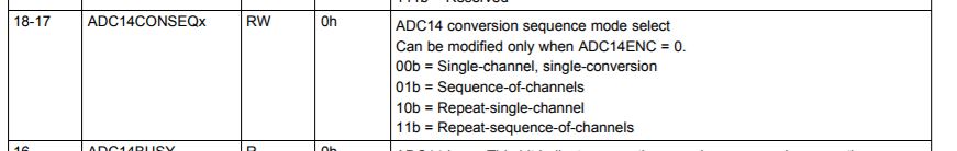

  • Wes,
       The timer trigger definition is found in the ADC14CTL0 register and in the datasheet.   So for example if you wanted to trigger the timer from TA0.1 you would pick ADC14SHSx = 1.
    I would recommend using the driverLib examples.  I found one here:
    Also, here is another attached:

    After doing some more research, I figured a lot out. I was assuming it would automatically start a conversion when the timer overflowed.
    I now have CCR0 set to the same value to yield samples at 44.1 kHz, AND I have a CCR1 value that will act as a way to initiate the ADC. See the screenshot below.
    For this to work, I need to be in pulse sample mode, when ADC14SHP = 1. My timer just needs to output a rising edge pulse, which will trigger a sample and hold timer which I have configured to last 16 clock cycles (ADC14_CTL0_SHT0_2). I'm using ADC14MEM0, so I'm configuring the SHT0 bits.
    Currently when I run my program, I get one ADC conversion, and then it never goes back into my ADC conversion complete interrupt function.
    I will also include my current code below the screenshot.
    #include "msp.h"

  • You need to select a repeat-single-channel mode:
    Chris
