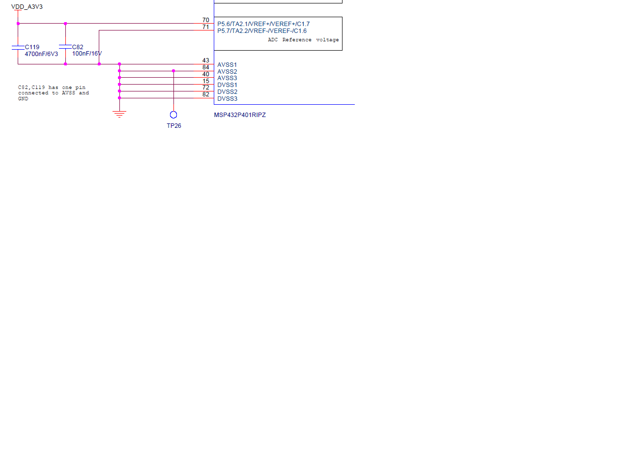

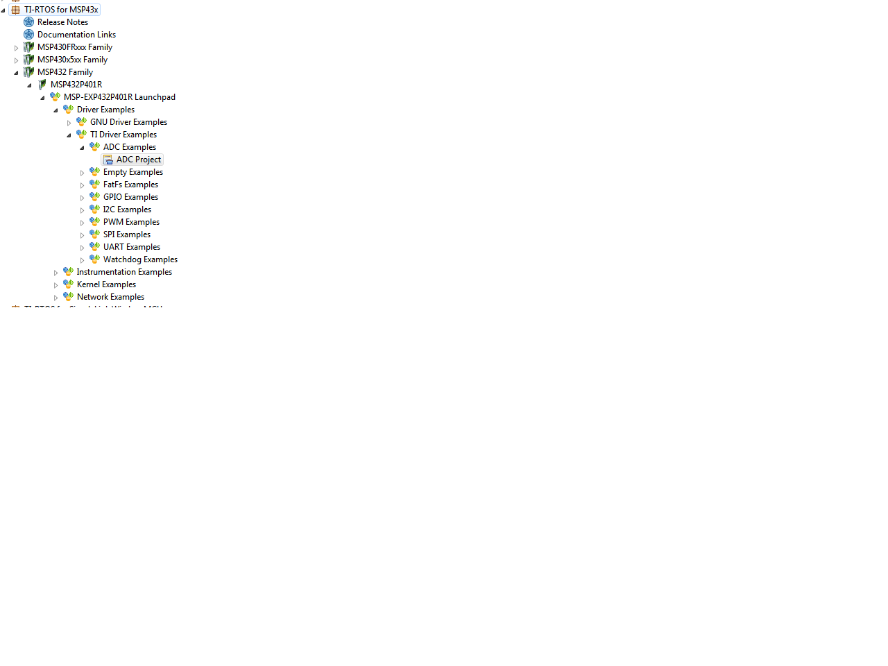

    We are using the example code from TI-RTOS in both cases (EVK and custom board). It is the adcsinglechannel project (see image attached below). I am not allowed to share the custom board schematic on a public forum, sorry! But i can tell u that we are giving 3.3V input to the circuit and connecting the AN0 pin (P5.5) to a DC supply and varying the input voltage to record various values. AN0 is just a floating pin in our circuit, very similar to the EVK. The only difference being, connections of VREF. See images below.
  • I would be curious if you see any difference between using the external reference and in the internal reference since in your application they are the same signal.   Is this an experiment that you have tried?  Specific to the analog voltage are there any other devices using this voltage?  What is the relationship between the analog and digital voltages (short, filter, open/isolated)?

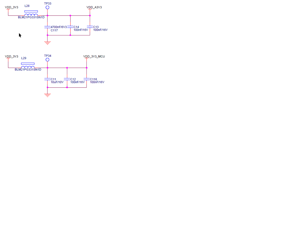

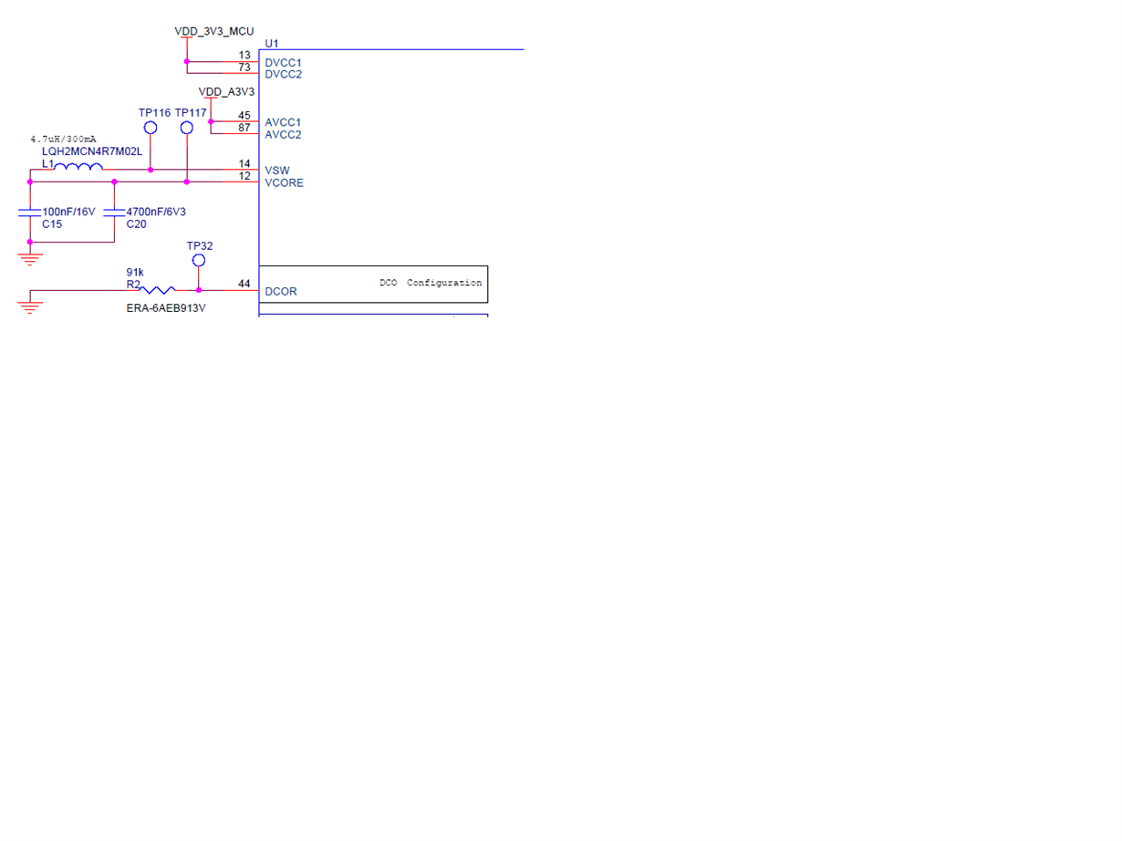

  • Hello Chris,
    * Internal reference and external reference yield same/similar results
    * Analog and digital voltages are separated by a capacitive filter, please see image below
    * No passives different from EVK.
  • Thank you Sameer. The possible sources of the differences would be the supplies, references, clocks, source impedance, and noise.
    (1) Supplies/references
    a. This does not appear to be the issue as there is good decoupling between AVCC and DVCC.
