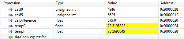

  •  Robert,
    FYI running this example, this is what I get. Let me know what you see when you upgrade!

    Can you please post a screen shot of what exactly you are referring to? You are stating you aren't seeing the values that I showed you in my previous post?
    Can you describe to me your hardware setup?
  • The problem is, I need to hover over the variable to display its contents, so I can't screenshot the contents of the variable.
    Unless there's another way.
    Screenshot:
  • I got it, watch expression:
  • My hardware setup for this test is a launchpad.

  • Robert,
    Ahhh this makes so much more sense. Do you by chance have a red LaunchPad on hand? The black LaunchPad contains Rev B silicon, that was experimental, pre-release silicon. A lot has changed in both hardware and software support for the Rev B silicon. Between Rev B and Rev C (released silicon which ships on the red launchpads) we fixed a number of errata and bug fixes in software.
    One of the gaps between Rev B experimental silicon and the Rev C production silicon was the fact that we fully populated the TLV table with the calibration values in Rev C, where we had not done that yet with the experimental silicon. You can go to the Registers view> TLV > ADC14_REF_2P5V_TSxxC which equates to 0xFFFFFFFF. This is the source of your issue and I was able to dig up an old black LaunchPad and confirm. On the red LaunchPad the values are the following:
    ADC14_REF_2P5V_TS30C = 0x00001352
    ADC14_REF_2P5V_TS85C = 0x000015F9
    Luckily, the fact that we have improved a lot of issues that were in hardware on Rev B, boads well for the rest of your project, but unfortunately, you will have to upgrade to the red LaunchPad.
    You can buy one here:
    www.ti.com/.../msp-exp432p401r
    You can reference a number of other changes at this link here: www.ti.com/.../slaa700
    In the meantime, you can use those values I gave above and they will approximately work. But I would like to stress the approximately portion of that sentence. The fact is, the values i've given above are calibrated to each piece of silicon and the characteristic variations of it. Given that it can vary from device to device, agnostic of revision differences, and given the amount of hardware changes between B and C, take your results with a grain of salt. On my black launchpad, with the values above, I was given 30C and 80F. Which sort of correspond with the values my red launchpad gave me. Example code below.
