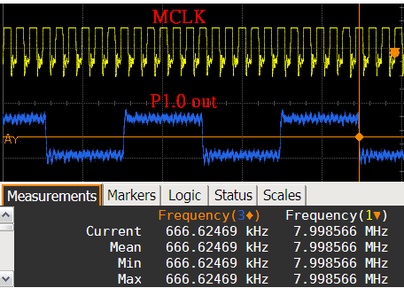

    BUT ,The  MSP430 of  P1.0  out  H-L  clk  only  650KHZ  , why????
  • That clarifies some of the code. 650kHz is around the default frequency of the MSp430 at startup, which might signify you did not successfully change the clock.
    Do you have a 8MHz crystal on XT2? A physical crystal?
    You set P5.6, 5.5 and 5.4 as outputs, use an oscilloscope to look the different clocks and verify that MCLK and SMCLK are in fact 8MHz.

  •  P5.6, 5.5 and 5.4 as outputs = MCLK and SMCLK are in fact 8MHz.
    but P1.0 output H-L = 650KHz
    I am use the MSP430F149 and MSP430F449  and MSP430F1611= The same result  .... why?

    it seems that the behavior you are seeing is correct. Note that the instructions of MSP430 takes 1 to 6 cycles (it basically depends on the addressing mode that are used for source and destination operand).
    So your main loop is:
      for (;;)
       // volatile unsigned int i;
        P1OUT ^= 0x01;                          // Toggle P1.0 using exclusive-OR
    To understand what is happening you have to take a look into the disassembly. This should look like this:
    Loop
       XOR.b  #0x01,&P1OUT
       JMP      Loop
    The XOR instruction takes 4 CPU clock cycles.
    The JMP instruction takes 2 CPU clock cycles.
    So if you toggle the port pin with software you see the 6 cycles between each edge of the output signal.
    For 1 period you need 2 edges... So 8MHz / (2*6) = 666 kHz....
    Easiest way to realize higher SCLK clock is to use a SPI module (e.g. MSP430's USART or USCI).

  • The XOR #1,&P1OUT instruction (the assembly pendant of the P1OUT ^= 0x01) takes 4 MCLK cycles. (an OR instruction would be only 3, an XOR with a bit value above 8 would be 5), then the loop jump itself adds 2 more.
    This is 6 cycles per toggle instruction or 12 per 'wave'. For 8 MHz this results in an output frequency of 666kHz.
