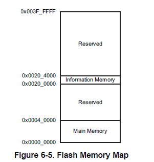

I want to know what address of MSP432 MCU is the address that we download the program in,and what address of MSP432 MCU is the address that the first instruction execute?if I want to execute a instruction from any other address,how can I do?
    The flash main memory on MSP432P401x MCUs can be up to 256KB and goes from 0x00000000 to 0x0003FFFF (Main Memory).
    On reset, the processor loads the PC with the value of the reset vector, which is at address 0x00000004.
    Out of reset?? Could you please give us more information on this use case.

    Actually I want to make a bootloader of my own.But I cannot know the loading address at powering up,and I also cannot know the downoading address when I debugging the program.Did the MSP432 MCU uses SRAM as default? How can I utilize the SRAM?

    I noticed that you didn't use the address of SRAM,did you just run your program in Flash memory or the SRAM is used automatic by the MCU?And,how did you download your program in specific address?Use #pragma LOCATION?
    Yes my program runs in FLASH but for the erase and program, these APIs are required to be executed from either SRAM or ROM and I'm using ROM
    Please take a look at the linker files. That is where I specified the memory map for each projects.
