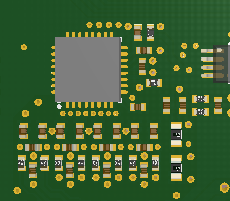

  • This is a 3D view of the PCB (just to find your way around).

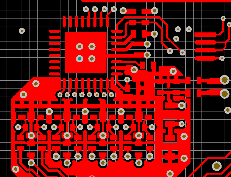

  • Top and mid layer. The mid layer runs the connection from the input filters to the analog input pins of the MSP430 and is AGND filled.
  • Ground planes and bottom layer. The bottom layer is filled by an AGND plane and runs SBWIO and SBWCK outside of the plane (and both signals are not connected while running the RF tests).

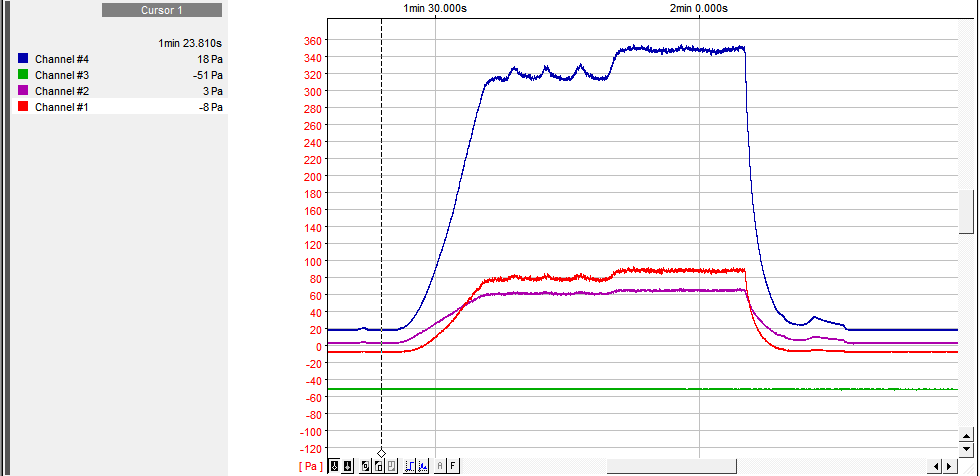

  • This are the graphs of the ADC data.

    Thank you very much for sharing all this information and the screenshots. It helps tremendously, especially for an issue and layout as complicated as this one.
    Looking at the connections from the input filters to the analog input pins of the MSP430, the routing seems to be similar and doesn't explain the differences observed on the various input channels. Also, since the rework of the input section (filters and better trace layout) did not change anything, I suspect that this area is not causing the issue.
    One possible cause for this issue would be if the analog traces are crossing between the AGND and DGND planes. During EMC tests, most problems are observed when traces are routed across a slot or a split in a ground or power plane. Since this routing causes both radiation and crosstalk issues, it is not recommended. Can you share a more zoomed-out screenshot of the Bottom Layer? I'm curious to know where the analog traces are coming from and that's not shown in the screenshot above.
    Another thing, I notice quite a few peninsulas in the AGND polygon on the Bottom Layer between the traces. If possible, I'd recommend removing them, since they can act like antennas and introduce additional noise.

    The analog traces to the pressure sensors run to the edge of the PCB and connect to another PCB which holds the sockets for the pressure sensors. Connection between both PCBs is done by an edge connector like the one found on DIMM memory modules. The bottom layer on the edge of the PCB looks like this:
    All polygons are done using the "Remove dead copper" option, so there should be no copper left that is not connected to AGND. Care has been taken that all signal traces have a valid return path, so no crossing of any voids in AGND of DGND (this is done even for signals that I assume to be low speed like the analog input traces). BTW, the first version of the PCB did not split AGND and DGND, so I would suspect that the split planes aren't the issue.
    The systems fails the RF tests regardless of the pressure sensor used. After looking at the graphs I suspected the pressure sensors at channel 1,2 and 4 to be the culprits. But nothing changed after swapping the sensors at channel 3 and 4. We even did tests without any sensor at channel 3 (ignoring the fact that open analog inputs aren't the best idea) and still channel 3 did not show any influence by the radio signal.
    The pressure sensors are similar to through hole ICs and are in fact located in an precision socket used for DIP ICs. There are no wires, just the pins of the pressure sensor. If the input filter is working as intended, I would assume that any high frequency RF noise picked up by the pressure sensor, the edge connector and the traces from the pressure sensor to the input filter get filtered there. Signals in the range of 120-140MHz should not be able to pass the filter and I think the noise somehow must get picked up after the input filter, i.e somewhere along the way from the input filter to the PGA inside the chip.

    We didn't do a simulation of the PCB. Actually, there is something strange to the frequency range the systems reacts upon. Any failure did show up between 100 and 140MHz, but the actual frequency has been different on different test days. First I thought this is due to the different PCBs tested (tolerance of the capacitors). But there is just one prototype of "version 2" and on one day the effect showed up between 136 and 139 MHz and on another day between 121 and 124MHz. The range is quite limited and shows really sharp edges, so that a change in frequency of 1MHz is enough to go from "no influence" to "offset by 6mV".
    Unfortunately, the graphs I have posted earlier are scaled to time (x-axis). But in fact everything left to the rising edge is just 1MHz below the failing frequency and shows no influence at all. Same holds true for the part right to the range. Once the frequency is just 1MHz above the error band, the influence is gone.
