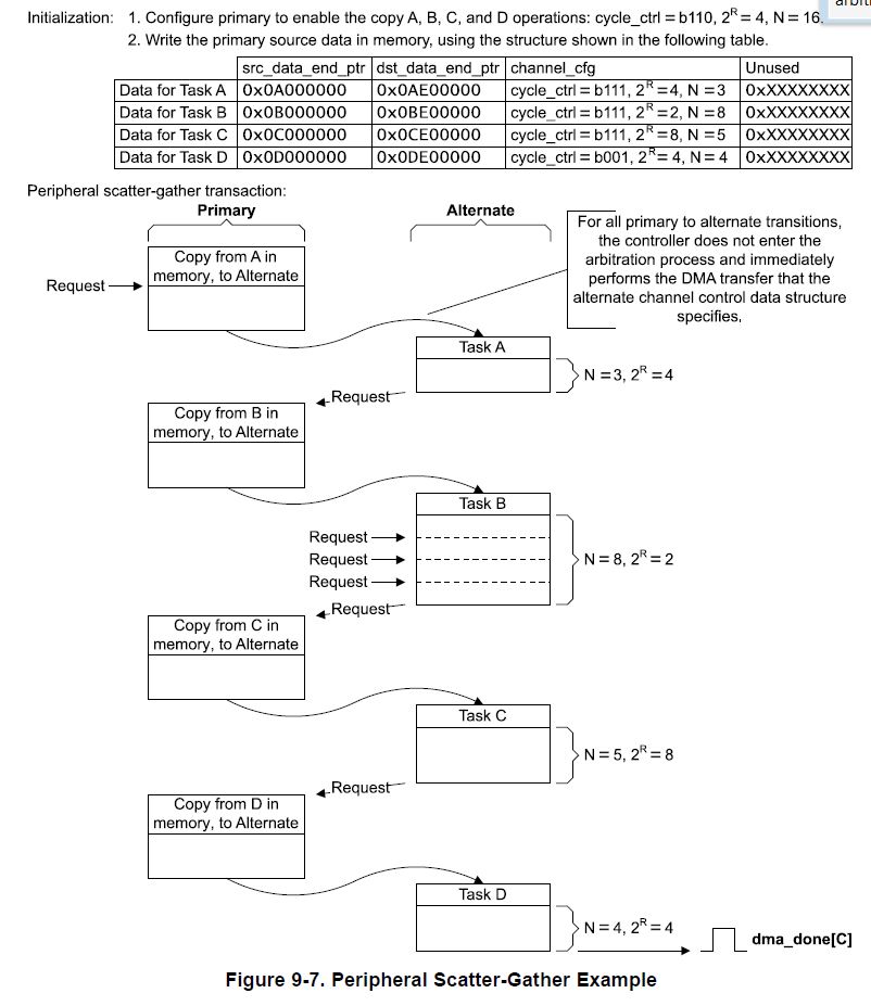

I’m working to get the ADC14 running at 200 kSPS per channel, alternating between 3 channels for a total of 600 kSPS. I’m running at 48 MHz, have the ADC samples being triggered by TIMER_A, cycling between 3 analog channels. I’m close to 600 kSPS rate using just using ADC interrupts & no DMA, but am missing samples, as expected. I started this way (without DMA) to get my input lines, clocks, & ADC doing what I want. Now, I’m trying to fold DMA into the mix.
I need DMA to handle 2 transfer scenarios:  (1) Directly into the SPI TX, and (2) Directly into a local RAM array (for pre-processing steps before SPI transfer).
I have scoured the Project|Examples|Resource Explorer, and don’t see anything this complex. Are there other sources of examples?
Apparently, there’s only 1 DMA channel that supports being triggered by the ADC (DMA Channel 7). If I’m sampling 3 channels (A0-A2), the DMA gets triggered after all 3 are scanned, so 3 transfers occur and the DMA interrupt goes off. Then, in the DMA interrupt, I have to update the destination address to move 3 entries down. This takes too long, so am missing samples.

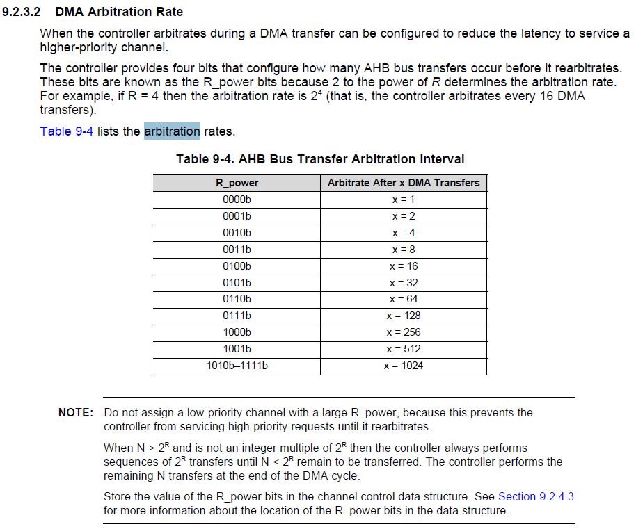

  • Blake,
        Technically you are not supposed to feed the ADC anything greater than 25Mhz (per datasheet http://www.ti.com/lit/ds/symlink/msp432p401r.pdf#page=65 ).  The ADCOSC is an internal 25Mhz oscillator intended for the ADC.  There are some subtleties about supplying the 24Mhz or 48Mhz and then dividing down within the peripheral, so I typically recommend just using the ADCOSC or a 24Mhz signal from SMCLK when using an HFXT.
        I have not been able to put together examples for both of the use cases, but hopefully the attached will give some ideas.  In this example I am running the ADC at 1MSPS and it moves through the sequence of three channels so that the effective sample rate of each is ~333Khz.  Also, I have not tested this in the lab, but just verified the timings.  Please let me know if you see any issues and I will try to get into the lab with this.

    Chris
  • Blake,
       The attached file is in error.  The arbitration should be set to 4 so that each ADC trigger that goes to the DMA (ADC triggers DMA at the end of the sequence) causes the DMA to move all three pieces of data (size of task set to 3).   I neglected the note found on page 450 of the TRM.
    So in the example I have provided N is equal to 3 and 2^R = 1.  Therefore the DMA will always perform sequences of '1' until N=1.  This will result in 3 seperate sequences each requiring a trigger and therefor each trigger will only move one piece of data although all three are ready.  This is also illustrated in the peripheral scatter-gather description (note task A):
    Thanks and Regards,
    Chris
