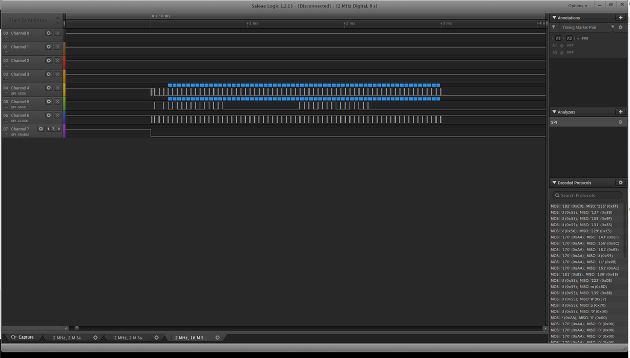

  • I don't see spi_b_init() here, but based on your Analyzer Settings I suspect you have the clock phase (UCCKPH) backwards. (In a pinch: Try all the settings. There are only 4 of them.)

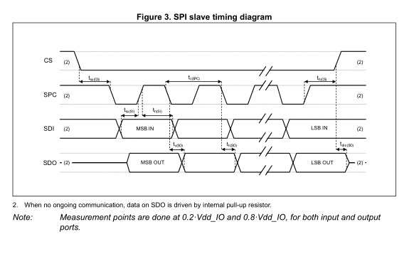

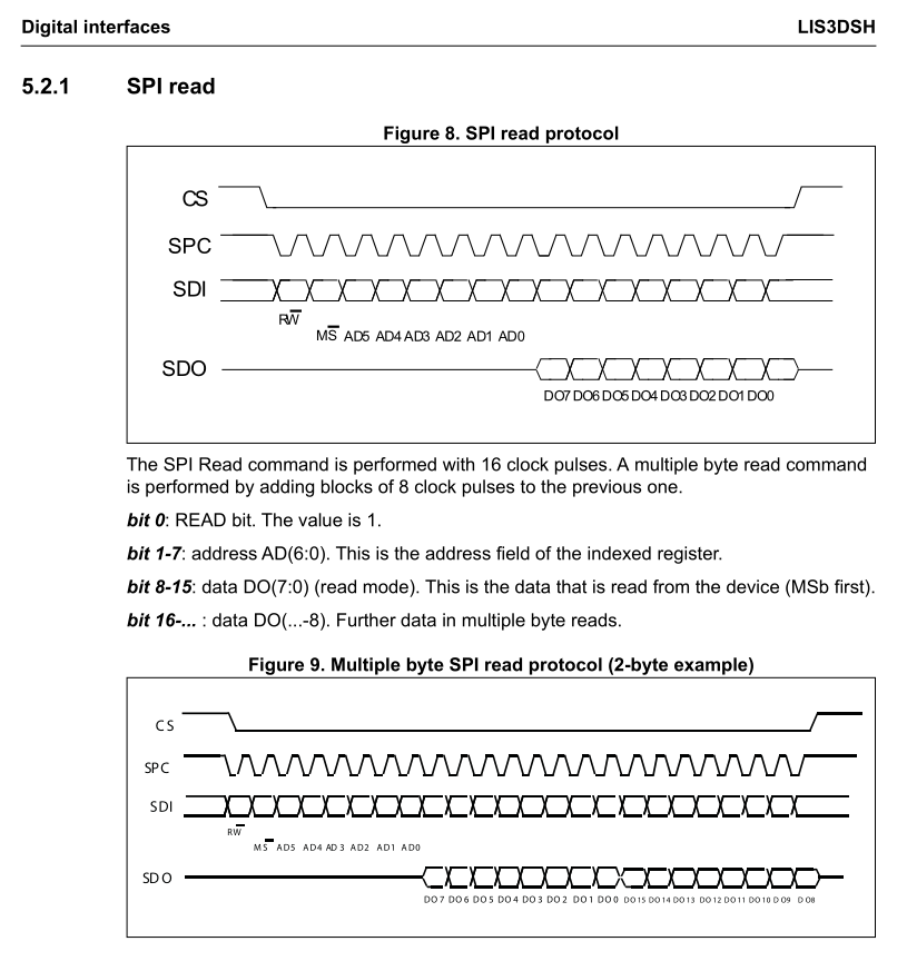

  • As I read LIS3DH DS sec 6.2 and SLAU367L Table 25-12, UCCKPH should be 0. Did you try it that way?
  • Yes, I tried that way too. By default on reset UCCKPH will be set to 0. I tried overwriting it as:

  • You mentioned that your (register) writes were succeeding. How did you test this (in the absence of being able to read them back)?
    I'm also a bit concerned about that low pulse on MOSI as you're starting the transaction. What's interesting is that this generates an I2C START condition inside the LIS3DH. One supposes that once you assert /CS it will switch mode to SPI flawlessly, but I'm not sure I would bet my project on it.
    I presume this pulse has to do with what spi_b_gpio_init() -- which I don't see here -- is doing. Even so, I suspect that if you move the LOCKLPM5 clearing to follow spi_b_init() that pulse will disappear.
  • Oh, and: Just for fun, try writing a "dummy" (second) byte that isn't 0x00. Something distinctive, like 0x5A maybe.

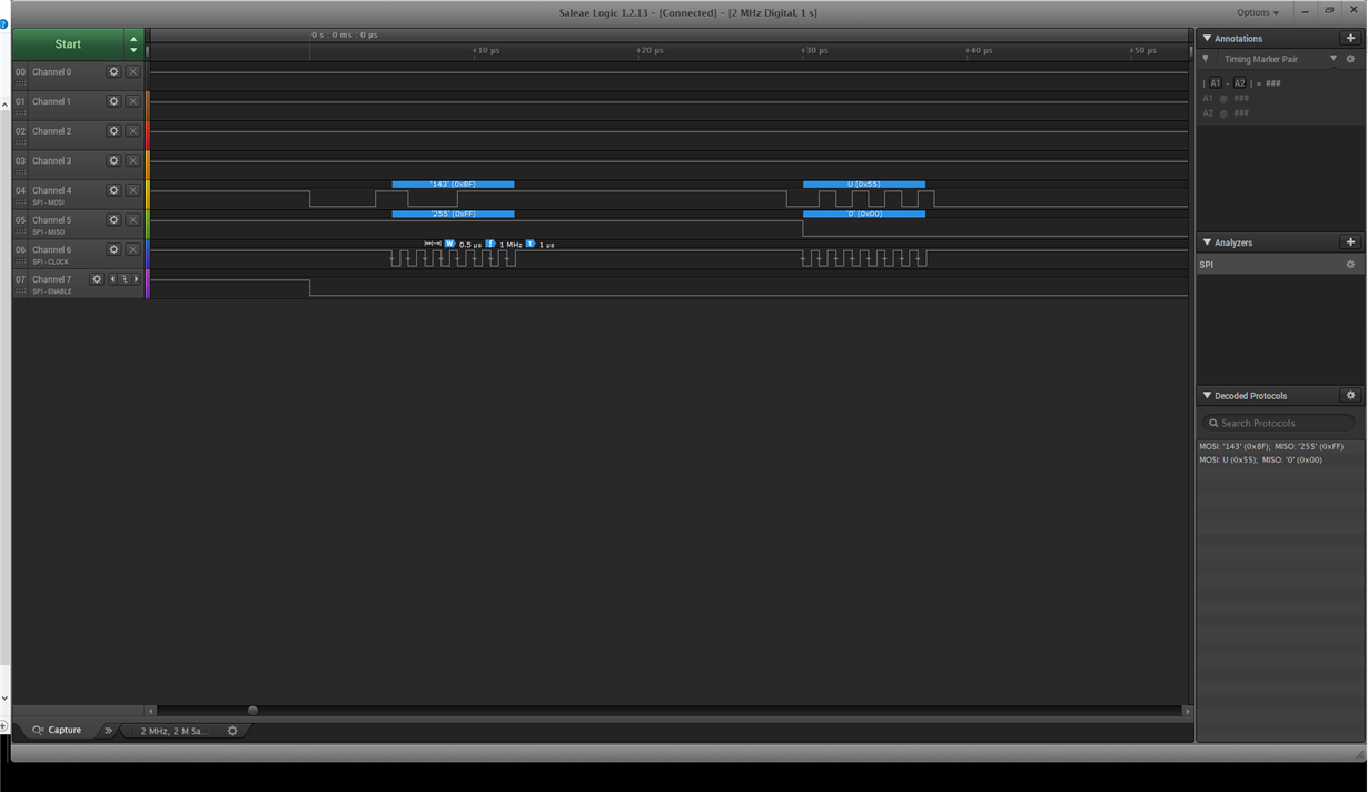

    I am driving /CS manually using P8.3, and here is the new capture from the logic analyzer.
  • I suggest you move the spi_b_gpio_init call to follow the call to spi_b_init. I think that will get rid of that stray MOSI pulse completely.
    Is this a commercial breakout board? Is anything else connected to/on it?
    The fact that the LIS3DH is driving MISO at the right time suggests that it is seeing the first (R/W) bit of the first byte. Try reading all of the registers by sending a 0xC0 first, then sending 64 dummy bytes. There may be a clue in the result. (Does it ever output anything but 0?)

    And the capture from the logic analyzer:
    https://www.dropbox.com/s/8ne15zj3o2ps8p7/0xC0.logicdata?dl=0
  • I can't read that capture file. What does it say?
  • The file I sent earlier can be by the logic analyzer. It has the capture as follows
  • The resolution in the .PNG doesn't really show whether the stray MOSI pulse is gone, but it should be. (I don't have your logic analyzer, so I can't fool with the signal myself.)
    At least it's evident that the device is capable of producing non-zeros. The results on the lower right don't look quite proper -- even the MOSI data seems to be skewed, which it wasn't before. You might want to re-check the Analysis parameters. (Note: UCCKPH=0 corresponds to CPHA=1.)

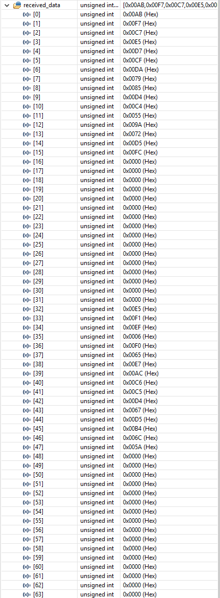

    What did you get in your received_data[] array? There's no big mystery here -- I'm anticipating finding a 0x33 somewhere in there, perhaps shifted/inverted/smeared and presumably not in element [15].
  • Some other things to check:
    1) How long are your patch wires? If they're more than maybe 3 inches long, try slowing down the SPI.
    2) Where are your logic analyzer probes connected? If they're at the MCU board pins, try probing at the breakout board pins instead.
  • Right, I have already set the CPHA to 1. Here are the contents of the received_data array:
    And I was able to export the data captured by the logic analyzer in CSV format. Here's the link to it:
    https://www.dropbox.com/s/jj9c1w8kfm18ccv/Capture_0xC0.csv?dl=0
