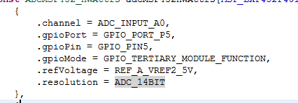

I just downloaded the MSP432F401R-ADC routine of the real time operating system and tried the ADC driver. I try to use examples and compile everything. However, the value ADC reads is lower than the actual value (from the multimeter).
The voltage is equal to 1.73V of the multimeter, and the ADC driver returns a tension of 1.0V (using the function ADC_convertRawToMicroVolts).
Here is the configuration of ADC:

    Here is my "adcsinglechannel.c" file source code, thank you very much!

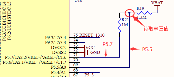

    The following is my principle, I connected the two resistors, the input voltage of the divider, the present situation is that the voltage input is connected to my 4V, tens of thousands of voltage meter reads the value of 1.6V, the universal voltage meter read value is 0.8V.
  • If I understand you correctly, your meter is reading 0.8v and the software is reporting 1.6v.
    Assuming that output on P5.7 is low and assuming typical 5-10% tolerances on the resistors, the 1.6v value seems reasonable.
    I do notice somethign strange in the code above in the first while() loop. Namely, you seem to be double-converting the  ADC result:
                res = ADC_convert(adc, &adcValue0);
                adcValue0MicroVolt = ADC_convertRawToMicroVolts(adc, adcValue0);
                voltage = (double) adcValue0 * 2.5f / 16383.0f;
                voltage1 = voltage1 + voltage;
    The function ADC_convertRawToMicroVolts() takes the input and ALREADY converts it to a volts value. From there you don't need the highlighted line which would normally be used to convert a binary value to an actual volts value (here, for a 2.5v reference and 14-bit ADC read).
    Can you confirm what are reading at each step in this sequence? (namely:
    1. what is the value of adcValue0 at each read?
    2. What is the voltage present on P5.7 ? or is this configured as an input?
    3. Is it your meter that is reading 0.8v on P5.5?
