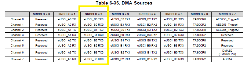

3.In MSP_EXP432P401R.c, I need to add the SPI configuration. But I find the tx/rxDMAChannelIndex for UCA0 in dma.h only have DMA_CH0_EUSCIA0TX/DMA_CH1_EUSCIA0RX.
So if i want to use UCA0, only DMA_CH0_EUSCIA0TX/DMA_CH1_EUSCIA0RX is usable?

My apologies for not answering before. For the SPI only these are the only DMA sources available:
Also you may want to review this thread: e2e.ti.com/.../538242
I modified the spiloopback example and I successfully tested that those sources are working correctly these are my board files for your reference.

You only use SPI_B0/1/2/3. Is it illegal to use SPI_Ax/Bx (some master/some slave) at the same file?
Please find attached all the project files. There is not restriction therefore I updated the board files so it uses SPI B as Master and SPI A as Slave.
