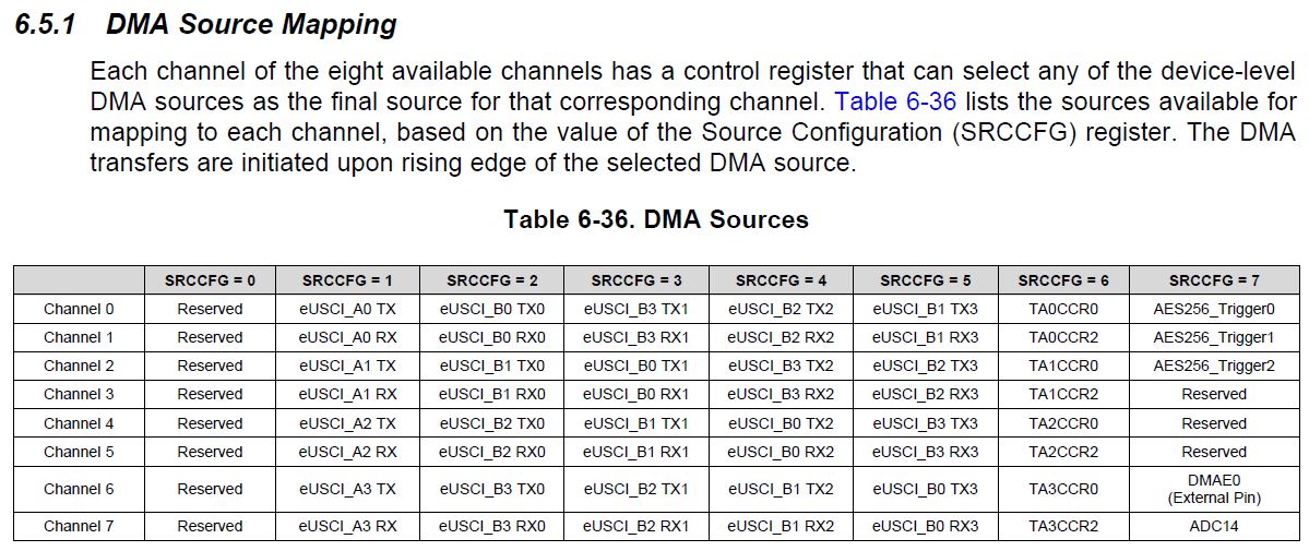

  • You could do this a couple of different ways.
    (1) You could have one channel triggered from RX(CH5) and another from TX (CH0).  This would mean that you would have to manually clear the txifg and then wait for the RX.  The task list triggered from the RX (CH5) would recieve the data based upon the peripheral scatter gather but the next to last byte recieved would use the memory scatter gather so that the next task which starts the transmit sequence would start automatically.  By writing to the TX buf the other dma channel (CH0) would start to move data into the TX as the TXBUF is available.  Please see the previously mentioned demo's on how to mix memory and peripheral scatter-gather.
    (2) You could have everything triggered from the RX (CH5).  You would still need to mix the memory and peripheral scatter gather to transition between the RX and TX.  The key is putting in 'dummy' tasks in the TX mechanism so that the DMA does not write to the TXBUF faster then it is actually transmitting data.
    Chris

  • Yuli,
    When the eUSCI peripheral is released from reset (you hold in reset to configure), the TXIFG is automatically set. If you were to enable a DMA channel which is triggered from the TXIFG , then the DMA would automatically start moving data. So as part of the configuration the CPU would clear the TXIFG before setting up the DMAs. Hope that makes more sense.
    Chris
    MAP_DMA_setChannelScatterGather(DMA_CH4_EUSCIA2TX,TX_TASKS,(void*)&txData[0],false);
    MAP_DMA_setChannelScatterGather(DMA_CH1_EUSCIA0RX,RX_TASKS,(void*)&rxData[0],false);

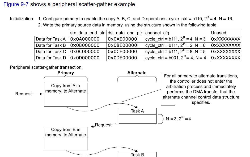

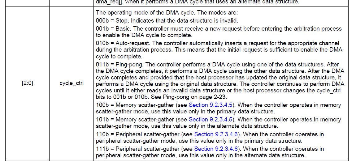

  • just cuirious
    DMA_setChannelScatterGather(.., uint32_t isPeriphSG )
    last paramether is telling, according to documentation.... "The flag bIsPeriphSG should be used to indicate if scatter-gather should be configured for peripheral or memory operation."
    from other hand it is already defined in DMA_TaskStructEntry macro last param - UDMA_MODE_MEM_SCATTER_GATHER.
    Why? Or do I misunderstand the meaning of paramethers?

    When we read from periphery (UART) we use  UDMA_MODE_MEM_SCATTER_GATHER
    when we write po periphery we use  UDMA_MODE_PER_SCATTER_GATHER
    Why? it is clear the second, I do not understand first...Both works with periphery...

  • Yuli,
    This is dependent upon if you want the task to be triggered from a peripheral trigger or auto-triggered. So for example, for the RX channel, each transfer from the uart to SRAM is triggered by the UART RX. Once all of the bytes are received a task should be auto-triggered to write to the TX buffer. Once that byte is moved into the shift register the TX ifg is set and triggers the other DMA channel to move another byte into the TX buffer and subsequent moves to the TXBUF are triggered by the TX ifg. Please keep in mind of which trigger you need and when (auto vs manual || memory vs peripheral).

  • Yuli,
        I am glad that this was helpful.  Coming from an MSP430 background I do not find the Scatter-gather very intuitive, but I think that is just because it is new to me.
      There is no reason to use the '+' instead of a logical or.  I think the logical or would be more appropriate in this context.  Moreover, the UDMA_MODE_ALT_SELECT is not needed because by definition the tasks are performed in the alternate channel while the primary channel is used to load the tasks into the alternate in the scatter-gather mode.  In more recent examples this definition is omitted.
