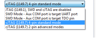

    B) Can you go to View>Target Configurations>Click on "MSP432P401R.ccxml">click Target Configuration under Advanced Setup and navigate to Texas Instruments XDS110 USB Debug probe and give me your settings? I'm particularly interested in the JTAG/SWD/cJTAG mode setting but please include them all. A screenshot will suffice!

    Settings in the MSP432P401R.ccxml is as below:

    Secondly I had tried all 3 options in the Target configuration window for the JTAG/SWD/cTAG section.  Except the SWD mode I tried the other 3 options
    We are not sure what should we select in the "The JTAG TCLK Frequency" and "JTAG Signal isolation" option so we kept what was default.

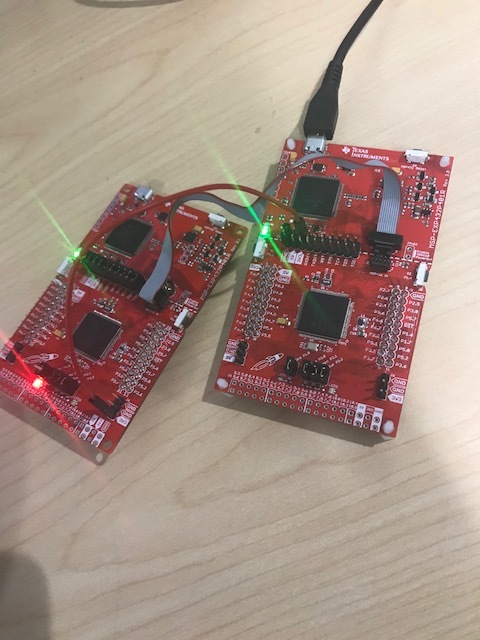

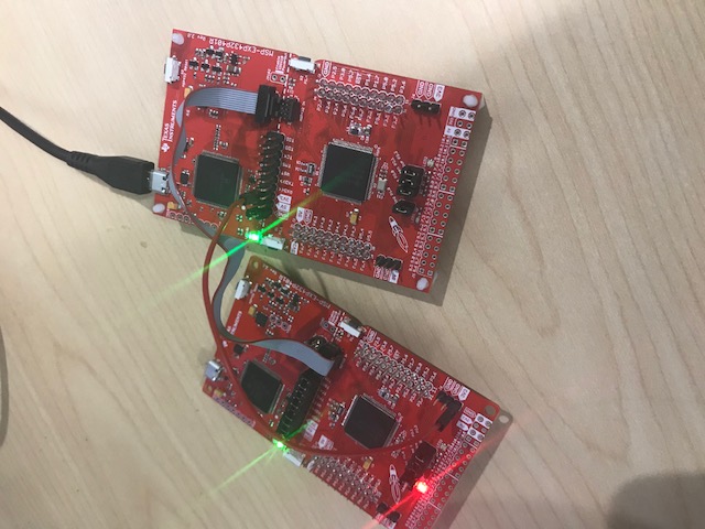

    My test set up for that is:
    J102 (XDS side) -> J101 (Target)
    3.3V on XDS side -> 3.3v on launchpad target side

    I tried to set up the same wasy as you did and guess what! The another launchpad got programmed over JTAG.
    Looks like something is missed on the Custom designed board.
    I will have to look into that.
