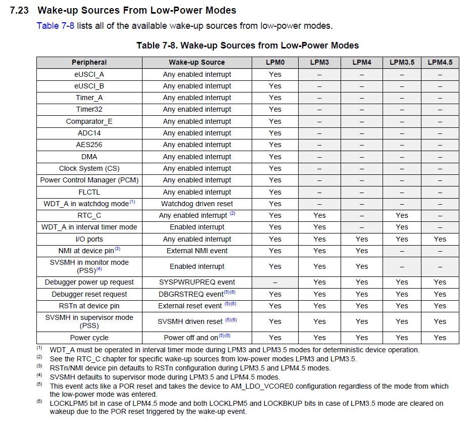

CCS/MSP432P401R: Can MSP432 UDMA work in deep sleep mode?
Part Number: MSP432P401R
 I develope a project that requires high power consumption. So it runs basically in LPM3. However, data communications will be used between SPI DMA and external devices. I mean, when DMA is working, MSP432 is running in LPM3 mode, when the receiving end the specified data length, DMA triggering CPU interrupt, MSP432 enter the LPM0 mode, continue to enter the LPM3 deepsleep after treatment, until the next DMA interrupt after the arrival of wake CPU.
Thanks a lot!
