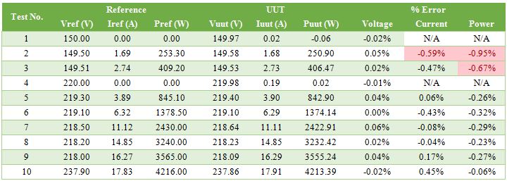

I have an MSP430i2040 sub-metering EVM. I followed the design guide to do the calibration. However, after being calibrated, the EVM still give current and power error higher than 0.5% in some test cases, especially at low load current. I want to ask if there is a method to improve the accuracy of current, power and frequency.

    First, I'd recommend calibrating the board at the RMS voltage that you'll be measuring. If you have to measure a range of RMS voltages, I've found that you can reduce the error by calibrating at an RMS voltage somewhere in between the min and max values. Finding that point takes additional testing but should help. A similar approach would apply to the RMS current measurements. If you've calibrated the board at 10A, try calibrating at a lower current (e.g. 1A, 5A) since you're seeing larger errors at low RMS currents.

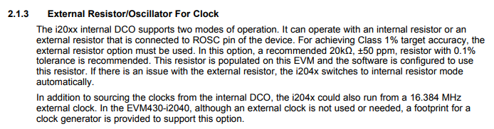

    Next, I'd recommend using an external oscillator resistor (not an external oscillator) with very high tolerance and precision. On the TIDM-SERVER-PWR-MON EVM, this resistor (R31) connects to the ROSC pin and is not populated. However, the pads are there. I've used the following resistor before, but it's pricey. I'd suggest buying resistors at various tolerance levels to find the cheapest resistor that will bring your error within spec.
    This external oscillator resistor is discussed in the User's Guide of the TIDM-TWOPHASEMETER-I2040 design. Please see the screenshot below. Refer to our code examples in CCS for how to select the external oscillator resistor instead of the internal resistor.
