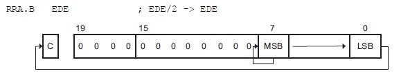

Hi all,
I am using my MSP430 to light up 8 LEDs in a circle. I want each LED to light up in turn then go back to the beginning. My approach has been to use general purpose register R5, the lower byte, to store the current LED. I later do a comparison with each bit to decide which LED to turn on.
I am in the process of writing two segments of code, one to increment the current LED and one to decrement it:

ledDown:        RRA.B         R5                      ; Shift right R5 (First 8 bits only)
                JNC           main                    ; Jump if not carry, ie if not on LED 1
                MOV.W         #0x80,R5                ; If Carry, ie LED 1 is on, go back to 8
                JMP           main                 ; Return

However, when I use the ledDown segment, I get the following:
R5 = 0000 0001
R5 = 1000 0000
R5 = 1100 0000
R5 = 1110 0000
R5 = 1111 0000
R5 = 1111 1000
R5 = 1111 1100
R5 = 1111 1110
R5 = 1111 1111
R5 = 1000 0000     which is not what I want.
Can anyone suggest why this is as I am struggling to figure it out using the datasheet alone? When I use ledDown, I don't know why it keeps producing more 1s instead of just shifting the existing 1 to the right. Surely it should behave like an arithmetic /2
