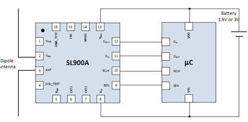

* MSP430: I'm using MSP-EXP430FR5969. and eUSCI_A1 SPI module: P2.4: UCA1CLK (32 kHz); P2.5: UCA1SIMO; P2.6: UCA1SOMI; MCU operates with CLK = 1MHz
* SL900A: as below, except pin 2 is connected to pin 8 (recommended in page 3 datasheet). Battery is 2.5V (but MCU is connected directly to computer through USB, so 2 different Vcc for SL900A & MCU).

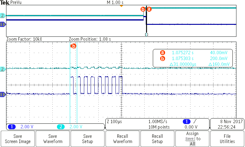

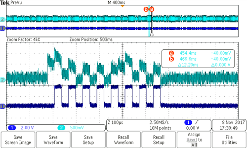

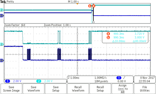

* Reading: when I tried to read data from FIFO (using Direct Command), I got only noise. Please see the pic below, when (1): SPI CLK, (2): P2.6 (UCA1SOMI). One more thing: I had to disconnect GND between SL900A and MCU. If their GNDs were connected, I got NO CLK (only spike instead of bit0-1).

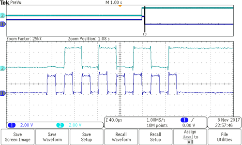

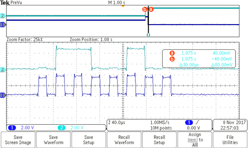

* Writing: I tried to write data (0x55) into User's Memory of SL900A, started at addr of 0x064. These are 3 bytes I wrote to SL900A. But then, the data were all 0 when I read User Memory from reader (RFID interface).
(1): SPI CLK; (2): P2.5 (UCA1SIMO)
Byte 1: 0x00 (Write Command)
Byte 2: 0x64 (Address of SL900A EEPROM)
Byte 3: 0x55 (Data to be written)
I'm so confused. Please help me explain these things. Thank you so much.
  • Minh,
    You are operating outside of the recommended communication operating condition of VCC +/- 0.3 V at each pin, since the MSP430 is 3.3 V and the SL900A is 2.5 V. Your code did not attach correctly but you will need to make sure that the clock phase and polarity settings are aligned between the two devices, although it appears to be correct from the screenshots. I notice that the CS pin should also be active high. Make sure to refer to the MSP430FR5969 SPI examples as well as any SL900A resources you might have found.
    Ryan

  • Hi Ryan,
    Thank you for your comment. I found out the problem of hardware. It was because pin VBAT (pin 13) of SL900A was connected to other "empty" ICs (the IC place  but no IC there) that I could not control. So I cut the connection of VBAT with other ICs, and now the voltage levels are correct. One battery for both MCU and SL900A and no more strange logic levels.

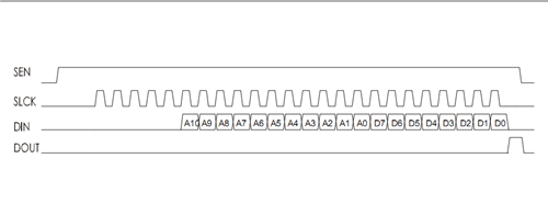

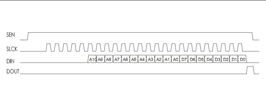

    However I still could not write/read data into/from SL900A. In SPI WRITE mode, I observed no "ACK" (the high pulse in DOUT) after all data have been transmitted as illustrated in chip datasheet:

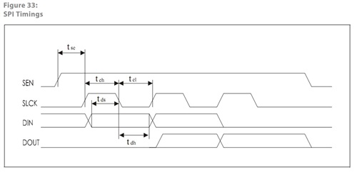

    There might be some reasons for this problem:
    - SPI CLK is too low ? (32KHz) Datasheet shows no minimum SPI CLK, just the upper bound (1-2MHz)
    - SEN pin is not deactivated after transmission has finished --> I tested this already. It caused no change, i.e. no data has been written into SL900A even SEN was been deactivated after writing.
    - Some delay after writing?  --> I put 10ms after each Tx (3 bytes in my case: 0x00 --> WRITE mode, 0x64 --> physical address of SL900A USER's memory, 0x18 --> data to be written).
    Still not working TT_TT
