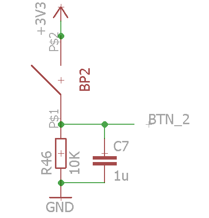

I have a push button connected in this way to pin 3.5 (input). When I press the button the micro reset.
If I add a 1K resistor the problem disappear. In both cases the the 3.3V doesn't drop down when I press the button, so I don't understand why the micro reset.
    Are you able to provide a schematic showing the connection of the other MCU pins, especially the RST pin? If the RST pin is configured for its reset function, it should be connected to a 47 kΩ pullup resistor and a 2.2 nF pulldown capacitor. Otherwise noise from pressing the button could cause the RST pin to generate a reset. How are you measuring the 3.3V power rail?
    Ryan
  • When you press the button, C7 is shorted to the power rails and will charge immediately. I doubt that this happens without affecting the power supply; how exactly did you measure the 3.3 V, with a multimeter or an oscilloscope?
    I have checked again the 3.3V with an oscilloscope, and you are right, the voltage drop to 2.3V for some uS. I checked the datasheet and it shouldn't be enough to reset the micro, but I'm not completely sure. I have also checked the RST pin (47k, 1nF), and on that pin the voltage stay at 3.3V.

  • From page 24 of the MSP430FR5969 datasheet:
    (2) Fast supply voltage changes can trigger a BOR reset even within the recommended supply voltage range. To avoid unwanted BOR
    resets, the supply voltage must change by less than 0.05 V per microsecond (±0.05 V/μs).
    I found out the hard way that the FRAM devices can be very sensitive to small (but fast) changes in the power rail even when the minimum levels are far from the specified minimum BOR thresholds.
  • Yes, I have a fast change in the voltage and it reset the micro, even if the power supply stay in the limits.
  • I have incorporated the code, but when I have the spike the communication with the MSP430 programmer go down. The most of times the code restart without interrupt pending, just once the micro reset due the BOR. Anyway I think the reset is due to the fast changing in the power supply voltage.
